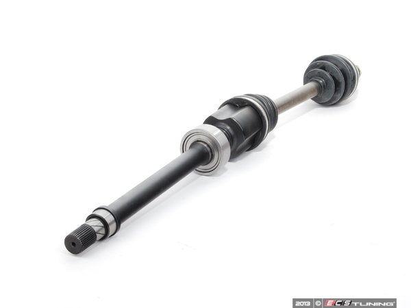

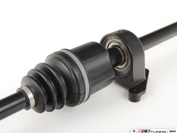

Just the brands and cost. Those are manual transmission , passenger side.
Also on that side the big difference is the OEM MINI one has the bearing with the bracket to the engine. On the aftermarket you get the full bearing but not the bracket, you have to fit the bearing on the shaft into the OEM bracket off the old one.
Genuine MINI with bracket / bearing.
VS aftermarket
