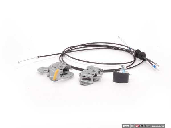

Also make sure the latches to the hood are even and one side is not up way more then the other when the hood is shut.
Part of this kit and linked above in the thread, they can be adjusted.
51231491315KT For vehicles with production date up to 06/2002
http://www.ecstuning.com/Search/SiteSearch/51231491315KT/
51237112440KT For vehicles with production date up from 06/2002+
http://www.ecstuning.com/Search/SiteSearch/51237112440KT/

Funny enough my 05 started to do the same thing... And as ECS suggested (and you have found) its a latching issue.
Mine is spontaneous, and now requires an extra firm push on the driverside to completely latch. I've adjusted it (two bolts) 6 ways from Sunday. I got it to close properly once, but the next time it didn't again.
Any suggestions on how to align it would be appreciated (with the fender liner out maybe?)

Hit the latch & that cable with penetrating oil. They don't like to catch and stick. The cables tend to rust as they are exposed to the elements in the front.
The latches dont have that much movement, but enough to bring the hood down some. Its a trial and error to adjust them. Open and close the hood multiple times while you move then from top to bottom.
