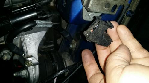

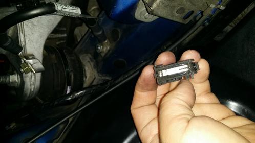

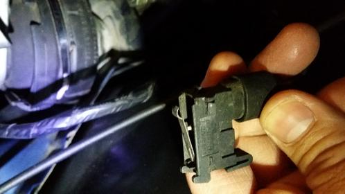

Hi!
I Found This On My MCS 04.
N' I'm Not Sure What Is?
Any One Can Help Me.......

Think that is your hood latch sensor...hard to tell...a less zoomed in pic might help...
Have a door/hatch open warning light? It was also used in the alarm system too.

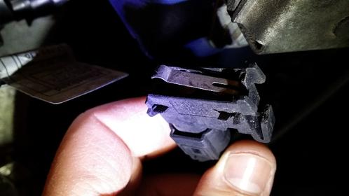

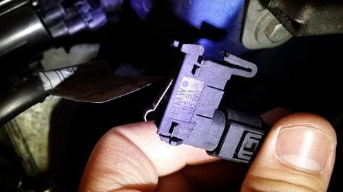

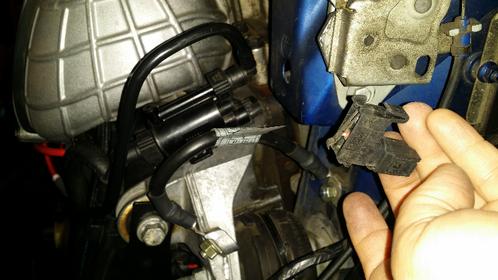

I Find Where That Sensor Need To Go.
The Clips Keep On Place There Broken.
N' Yes ZippyNH.
Is The Latch Sensor.
Thanks Again!

Its the hood / bonnet switch:
Here is the hood one for the R50 R52 R53 . 61311480861
Info:
https://www.northamericanmotoring.co...eedometer.html
Part 61311480861 Engine Hood Microswitch
http://www.ecstuning.com/Search/SiteSearch/61311480861/
Just snaps into place, they can break if bumped when messing with the latch lock or the engine bay.
