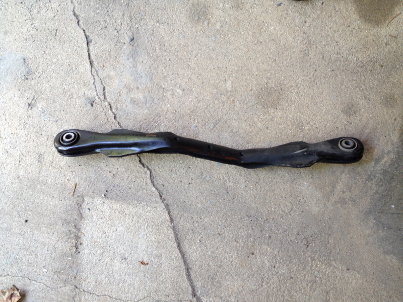

Here is a picture of what you don't want to see

FYI upper and lower are the same. You actually could've swapped a good lower with the broken upper one and bought a pair of aftermarkets to use on the bottom

Originally Posted by Kahnfucious
Thanks guys...I decided to go with stock for right now. Had it been the lower control arm I would have upgraded...money is not so free flowing these days. Couldn't justify double the cost.
That's nasty! In this case I'd say the upper arm gave its life for a good cause!

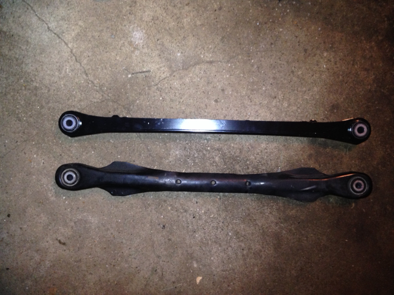

So I wanted to share a picture of the old vs new design of the control arm. Upper is new.
I bent the old one back to show what stock looks like...two blows with a sledge.
Shocked that BMW let the old design go out....not shocked that people were having failures. Granted this is a lemfoerder (OEM supplier) version but I'm sure it represents a pretty accurate depiction.
My lowers are also the older design...suspect I'll be upgrading those when money allows.
Of course the bottom one will get TENSION when you hit a bump while the upper will be in COMPRESSION. I'm sure even the old design is strong enough to withstand the tension without pulling apart.
But you might want to swap the lowers out anyway just to be safe. They are remarkably different which is surprising.

Good points...yeah I guess it would take a lot to pull apart the lowers. The uppers take a bit more abuse I guess.
Swapped the drivers side upper the other day - was much quicker than the right side having been through it. The only complicated part about it was counter holding the bolt that goes into the rear subframe. There isn't a lot of room to get a socket and wrench up there. I used a breaker bar because it was thinner than my wrenches. A ratcheting 18mm wrench would have been great in this instance.
