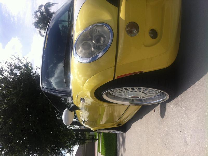

Hello!
I just installed megan ez street coilovers and ie adjustable plates. The rear is just slammed tucking tire, and the front is about 1" wheel gap. What all can i do to lwer it more in the front... I dont care about harsh ride etc.. One of my other custom vehicles is a bodydropped truck, so no worries about ride
Once again, ive got ez street coilovers, ie adj plates, hotchkis rear lower arms, and 18x8 et 35 wheels, and want the front to come down more. The coilover is all the way down.
Your thoughts and ideas please?
Thanks in advance!

Old Jun 23, 2014 | 07:58 AM
Newby05mcs's Avatar
Newby05mcs
Joined: Jun 2014
Posts: 43
[ATTACH]https://www.northamericanmotoring.com/forums/attachment.php?attachmentid=94934&stc=1&d=14035353 55[/ATTACH]
Heres how she sits this morning.. Camber out back is straight after rear arms installed, and front fender is just over tire

Old Jun 23, 2014 | 12:30 PM
slomofo's Avatar
slomofo
Joined: Feb 2013
Posts: 58
Just a thought here but the camber plates that you are running are fairly tall if I recall. I would assume you ditched the mounting hats that came with the Megan setup and are using the IE instead? If not, that is a lot of extra thickness right there. Below are the pics of both (duh) and stacked would add an extra inch.
In regards to cutting, it doesn't hurt to cut a dead coil on a progressive rate spring. The dead coils are there to set the ride height when the coil is made. Cutting them won't change the spring rate. That was told to me from an engineer at Bell Tech many years ago. I've done that numerous times.
Old Jun 23, 2014 | 12:40 PM
Newby05mcs's Avatar
Newby05mcs
Joined: Jun 2014
Posts: 43
Thank you, yes i removed the top mounting hat from the coilover, and used just the camber plate components. Yes they are a good 1.5-2" thick from top to bottom. I thought about installing without the plates to see where it would be, but its just about there now where i want it, and the wheels dont lean in!
If it came down 1/2 more that would be cool, but if it stayed where it is, that would be ok. Im just tryin to figure out how some get slammed/tucked up front without bags.
Thanks again for your ideas
