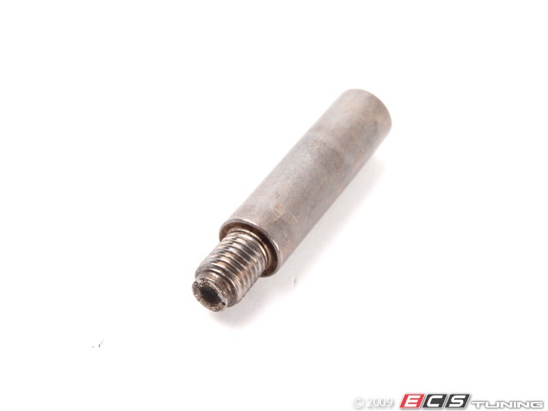

Clean the guide bolts off and if there damaged or etched really bad you can replace them. Otherwise some Emory paper or a very fine grade sandpaper. Two per rear caliper.
http://www.ecstuning.com/Search/SiteSearch/ES59451__ES2628388__ES2574677/
