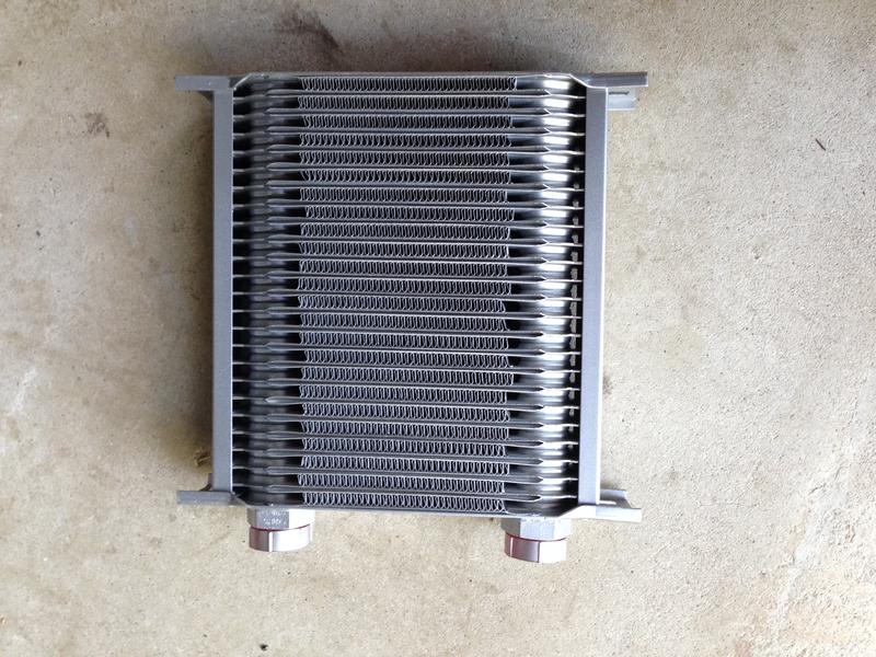

I was hoping someone could help me with my RMW oil cooler install. I've got the front end on my MCS off. I can see where everything is supposed to go, however I cannot seem to figure out how to mount the oil cooler. I've reviewed other manufacture installs, but want to make sure that I'm not causing harm to other components. Any suggestions at this point would be helpful.

Take a pic or two of what you've got to work with and we'll try to help.

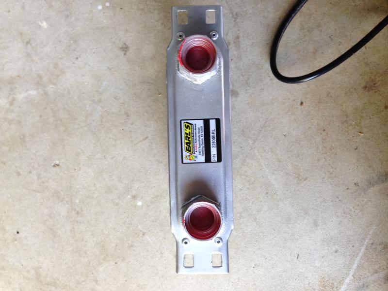

I've attached three images to give you an idea of what I'm dealing with.
If I attempt to place the cooler under the bumper there will be at least a 1/2" exposure at the bottom, kind of freaks me out, if I catch rock it's toast. Again I'm unsure as to where to cut/modify the bumper if needed The mounting brackets similar to quick mount zip ties with an anti-vibration pad.

Did the cooler come with any other mounting brackets? How long are the lines?
If I was fabbing up something, I would use some L brackets and mount it to the bottom of the bumper bar.

Would have said to mount it to the top of the aluminum bumper there, but that thing is huge! Hang it from the bottom, looks like the only place it'll fit.
