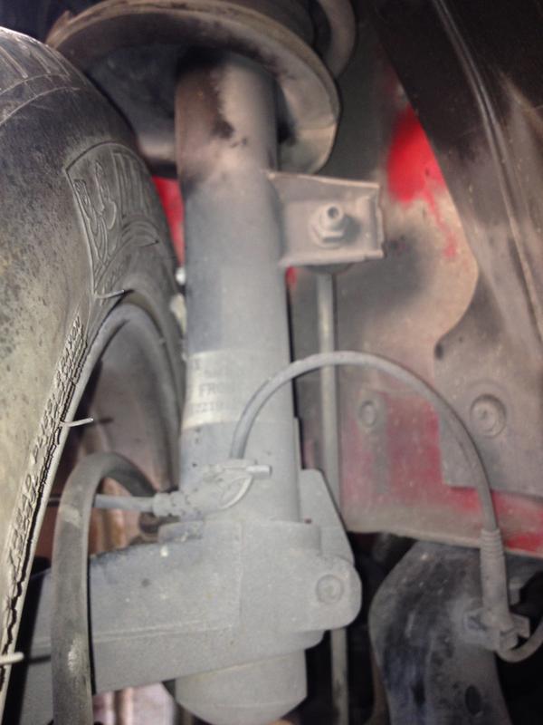

kk here are pics of the passenger tire, strut tower and the strut notice the divot where the sticker is and then it runs upward and bulges back out also
3 of my tires have wavy sections on the inside cupping maybe? I think the dealer and the previous owner just moved the tires around on the passenger side to make the ride better because its rides rough as crap on that side at 30+mph since i bought it. Oh, do i need to have the strut out to beat the mushroom down on the tower?

Well that strut tower is definitely messed up. You don't have to remove the strut to pound it back. Just lift that corner of the car up.
I don't know that the deformed strut tower would cause that much negative camber though. But start with fixing the strut tower then see how things look

OK so yesterday I replaced both passenger and driver side struts inspected the mounts (they were fine) and beat the passenger side tower back down a little with a 2x4 and a hammer... so now the tilted wheel on the passeneger is alot better... and the drive was getting really bumpy at 30mph now after new struts it is bumpy at 60mph.....So today i took off all four tires, they all had a decent amount of inside wear so i put the best one on the front passenger side now I get a little vibration(not as bad as it use to be) at 70mph....so I am thinking that 4 new tires (cause obviously the previous owner and the dealer just rotated them around on the bad passenger side so they all wore unevenly on the inside) and an alignment will do the trick and make my ride a lot better but will the alignment also take out the little bit of negative camber i have on the passenger side..oh and reinforced camber plates is it possible to make them myself has anyone tried and if so what thickness metal should i use? All and all strut change out are easy but the tower reshaping beat the hell out of me any tips on beating the towers back down so if i have to do it again and also I read somewhere that doing the 2x4 and hammer trick is terrible for the tower and cause metal fatigue?

Your struts probably weren't the source of the negative camber on the wheel but it certainly isn't going to hurt replacing them on an older car.
The alignment isn't going to help. The camber in the front isn't really adjustable. There is a slight amount of adjustment using slop in the bolts but there is no factory adjustable eccentric bolt or anything like that. So if the camber is off more than a few tenths of a degree an alignment won't help. You could make reinforcement plates yourself but unless you have access to a machine shop and/or a lot of spare time it's probably best to just buy a pair. If you make them out of aluminum I think they're normally something like 1/2" thick.
Yes bending metal one way and then another will fatigue the metal. I wouldn't be too worried about it though. You'd have to bend it a bunch before it was significantly weakened. And you're going to strengthen it with a strut tower plate anyways.
