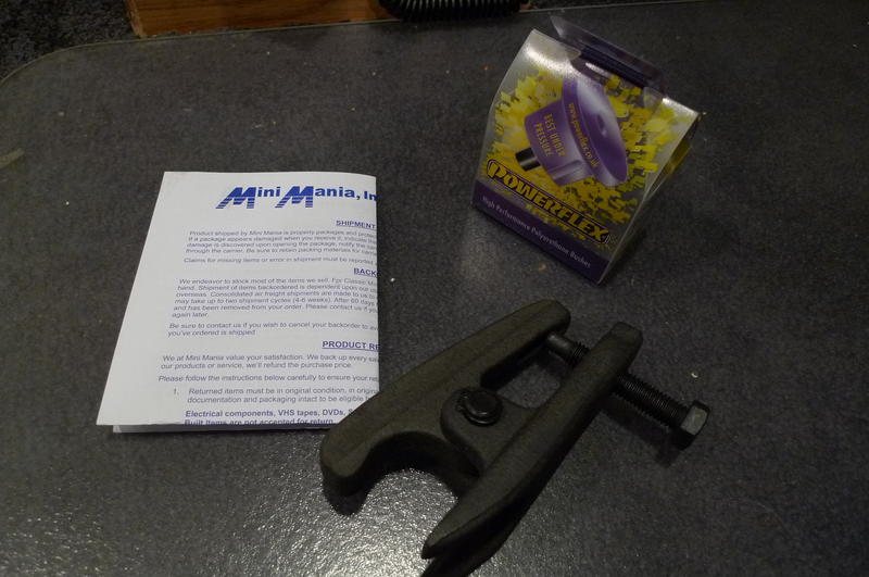

Before leaving I threw a 10mm bolt with a ton of washers on it in to keep it from wiggling. Mini dealer by me didn't have any of the right ones in stock and local hardware store only seem to sell standard bolts and nuts.
