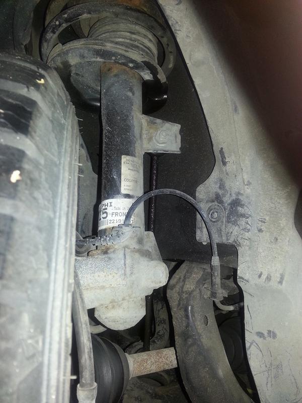

After coming back from shopping with the family is morning I see a puddle under the front right side of the car. Earlier this morning I was taking the garbage to the garage and thought I smelled trans/gear oil but thought it was just the garbage I was holding.
Drove home from a friend's house last night, and hit a pot hole, nothing crazy, I shrugged it off.
After further inspection there is fluid all the way up the strut and is leaking onto the control arm.
Any ideas?
I didn't think there was that much fluid in a strut, maybe I'm wrong?
I'll be getting it up in the air and checking further right now.

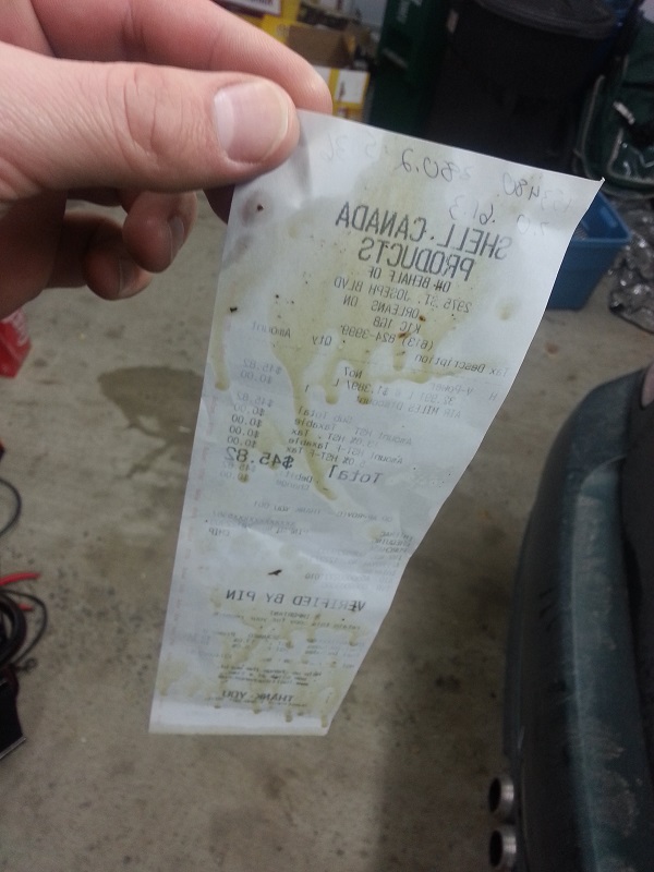

I tossed a white receipt down to see what color the fluid is, here what I found.
And it still smells like MTL

Same thing happened to me. You'd be surprised how much oil is in the strut.

the oil in many shocks is often gear oil or something very much like gear oil.

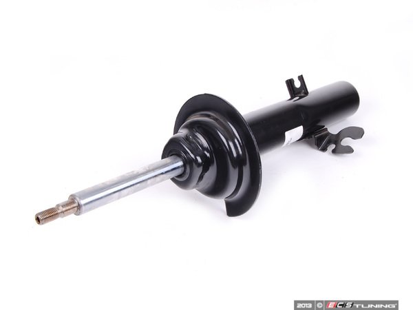

I can't afford new struts right now. They gave me the wrong part at the wrecker anyway. Part number is 31316759420. That part is not available on RealOEM and from a few searches on google its a Euro part from the Cooper One and One D.

MINI part # 31316759420 Supersedes to 31316780466
http://www.ecstuning.com/Search/SiteSearch/31316780466/
OK, so it is the right part number, just an old one. It actually came with a spring too but its not the right color markings on it. So I'll swap it with mine.
