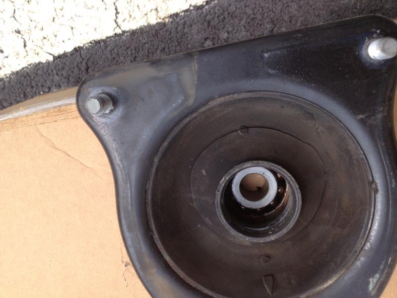

Long day. It all started when I noticed the top mount cracked on the passenger side. I ordered the fixed camber plates because I am on a restrictive budget a can't do the entire suspension yet. Besides the car only has 40k on it so it seems that I should be able to get a little more out of it. I put on less that 400 miles per month including autocrossing. Anyway, I got the mounts and since all my tools are in NE and I don't have a garage I started looking for someone to install them. Two recommended shops said no and a third said sure. It will be 4 1/2 hours at $125 and no it wasn't the dealer. After thinking about it for a week I went and bought a jack and jack stands. Then I rented a spring compressor and borrowed a storage unit to work in. Using several DIY's including Blimey's "How a stud lifts a Mini". I did the job my self this weekend. I took about 4 hours to do the swap. I don't have air so for the top nut I used an old sparkplug wrench and an allen wrench. A few short lengths of pipe gave me enough leverage to get it loose.

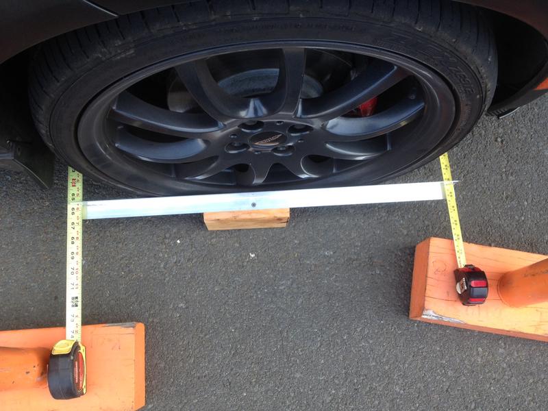

The alignment took another four hours as I had a senior moment and forgot to consider that a 1/4" on the tie rods is considerably more at the tire. After lots of trial and error using a home made toe setup I got it to an 1/8" and the wheel is straight going down the road. I wanted a 16th but was too tired and said, close enough. It had an 8th when I started. There is noticeably more camber but I cannot check that. Trying to tag a couple photos on the end here...we'll see.
