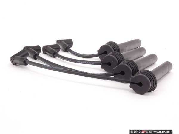

Not that hard at all.
For the coil , they can be on there a little tight, grab the 90 degree angle of the boot closest to the coil and pull horizontally. Sometimes twisting a little before pulling helps them com off if there is a little corrosion on the terminal. The spark plug boot you grab the top and pull up. They will clip off. You can grab them pretty good right above the rubber skirt and top rubber nub.
http://www.ecstuning.com/Search/SiteSearch/12127513032/
If you are missing the factory clips for the rear wires to keep them seprtated #3 #4 plug on the back . Here they are.
http://www.ecstuning.com/Search/SiteSearch/07131487247/
