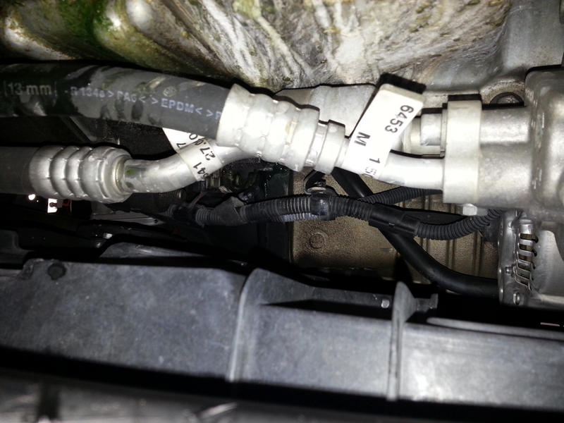

I bought an 06 Cooper S a week ago. It has 113000 miles and I wanted to start doing some preventive maintenance things beginning first with a new belt and belt tensioner. The first thing I noticed was a small puddle of anitfreeze under the front of it. I jacked it up and it looks like it may have been leaking for some time as can be seen in the pictures. Also there is no shield covering the bottom of the engine? Should there be one?
Can someone identify where the antifreeze is likely coming from? Eventually I want to replace the oil in the SC and also replace the water pump. Is this more urgent than I expected it?

Looks like a water pump or thermostat to me. The water pump is on the ''right'' side of the supercharge (when facing the engine), so if it leaks, it will go down near this area!

No one has pointed out the fact that - that *hit is GREEN!!!
The Mini coolant is blue. The green stuff isn't supposed to be in our engines (steel and aluminum metals in the engine - so they want their stuff only).
I've seen my share of leaks and that's not insignificant. The thermostat housing is certainly a good place to look as well, it's a common leak point (even though its more to the top right)
If someone screwed up the coolant type I'd be looking for the receipts to see who did it and what they did, perhaps that may lead to more clues.
I'd get that coolant flushed immediately.

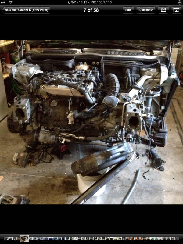

here is what it looks like when u get that deep.. this is when I had my SC rebuilt.. now if you do attempt to do it. one thing I would do next time is install this in the SC So I can check and change the oil. http://imperialmini.com/ Recharger.

Don't get too scared about that image. Pick up a Bentley manual and it will describe how to get there.
I have recharger #17 with my original SC (I have a new rebuilt SC on the engine now)
It was a pain to install, but I thought it was worth it to take care of the oil level on older SC's.

yes it's not that difficult if you have the right tools .. but I just thought I'd show you a realistic picture of how deep u get into the car.
