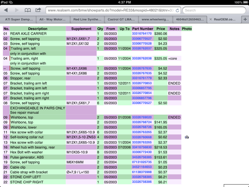

I was going to suggest that it would be a good time to inspect and repackage the real wheel bearings with fresh grease... However it looks like it may not be built that way. According to this, part #16 is the hub and bearing (as one sealed piece I assume)
You'll definitely need a torque wrench. Don't let the brake caliper hang on its hose, get an old coat hanger and make yourself a hook. But looks to me like you just remove the caliper, the disk, then the hub is right there.
Difficult for me to make suggestions, I've only had my MINI for a month. Remove and replace hub sure looks to be pretty straight forward from here, but I also bet that other things have rusted a bit. I'm guessing there will be a single flush mount screw that locates the brake rotor in the hub. If its a Phillips head, make sure you have the right size screw driver, unlike torx or hex heads, if there's a little play it can be easy to choose the wrong size screw driver, you wouldn't want to round it out.
