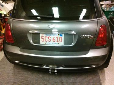

So before I took possession of my r53 I was all about changing the exhaust.. until I started driving it. Felt the tone from the OEM exhaust was great.. loud enough to hear, but quiet enough to not bother my lil man ( 2 year old son). I did however hate the look of the beer can tips. So I stopped off at a local exhaust shop and bought some nice tips. I knew they wouldn't work as is but I have a killer set of tools and some fab skills.. lol. The set screws
were seized if course, so I had to get creative with a cutoff wheel. While I was at it I replaced the broken left muffler hanger and the cracked tailgate handle with new LED plate lights. Was a good afternoon.

Nice look for sure. Quick question is your car like on the ground or is that just the angle of the shot?

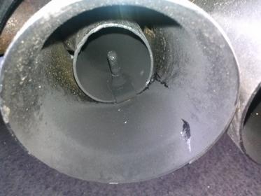

How did you end up mounting the new ones? Did you just drill and tap the new tips to mount them? Looks really good, never thought mine looked bad but those look awesome!!

The car is lowered with H&R springs, so like maybe lowered an inch..
The angle might be throwing it off a lil in the pix...
This is the rest of the car
I cut the stock pipes back a couple inches and drilled through.. slid a threaded "J-Clip" onto the pipe, Drilled a corresponding hole on the tips and inserted a metric bolt.. Nice and tight and allows for some adjustment too..

How hard would it be for you to get pictures of how you mounted it and what you used? Not trying to copy at all but now you got me wanting to do something like this!! Have you done the one ball delete yet? Or has it been done to your car already?

Not hard at all. Will try tonight for u

Sorry it took so long... here's a quick pic a bolt comes up from the bottom into this threaded clip inside the tailpipe. I painted it all black inside so you have to stare into the tailpipe to see it.. aka not visible unless you're looking for it.
