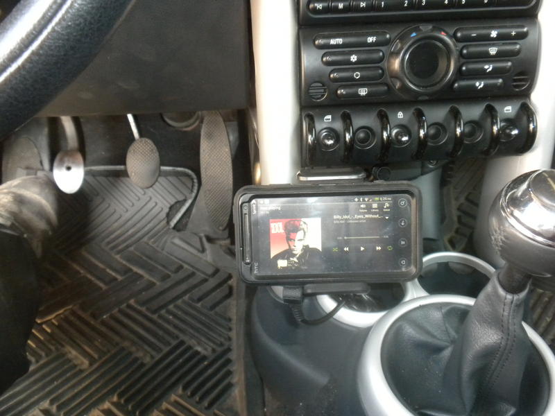

I ended up buying the bluetooth/usb kit, I love it, I however do not have to use their app, I am using my music playing widget on my android phone, works great, plays all my songs and I can use the steering wheel buttons to boot. I included a picture of where I installed the kit, I just used two sided tape to hold it down, so far so good..

I have the Alpine stereo, I talked to one of the guys there and he recommended me to install it up by the stereo because of the supplied mic. As far as using the mic by the mirror, I dont know, I used the supplied one and if you look at my second pix, you can see it to the top right of my phone, underneath the door toggle. Hope this helps. Also, I dont think it matters what phone you have as long it has bluetooth, the voice on my kit actually says iphone,usb,aux for options..
