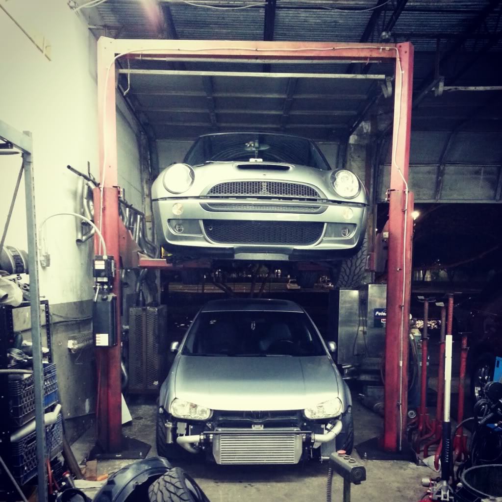

After taking stuff apart we found that it was the harmonic balancer that was done. Ordered an ATI super damper that should be here by tuesday, hopefully installed before my final on wednesday
Here are both (husband and mine) cars down for further construction. lol
