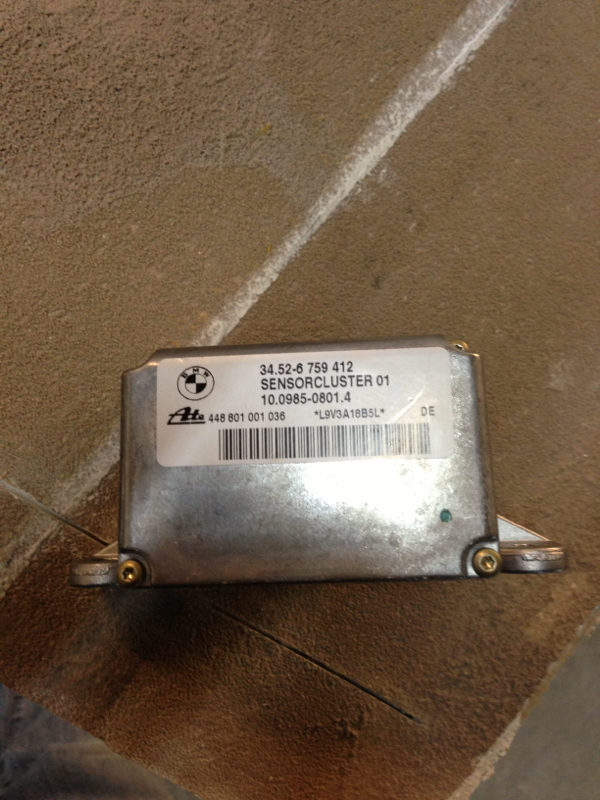

Here us a picture of the yaw speed sensor thats located behind the hand brake
Old Apr 10, 2013 | 05:16 AM
  #132
Mariano305's Avatar
Mariano305
Posts: 46
I replaced it and gone never again

Yes i got that sensor used for $40 new it cost $320 and you can do it your self it will take you 30min tops just make sure you disconnect the battery
