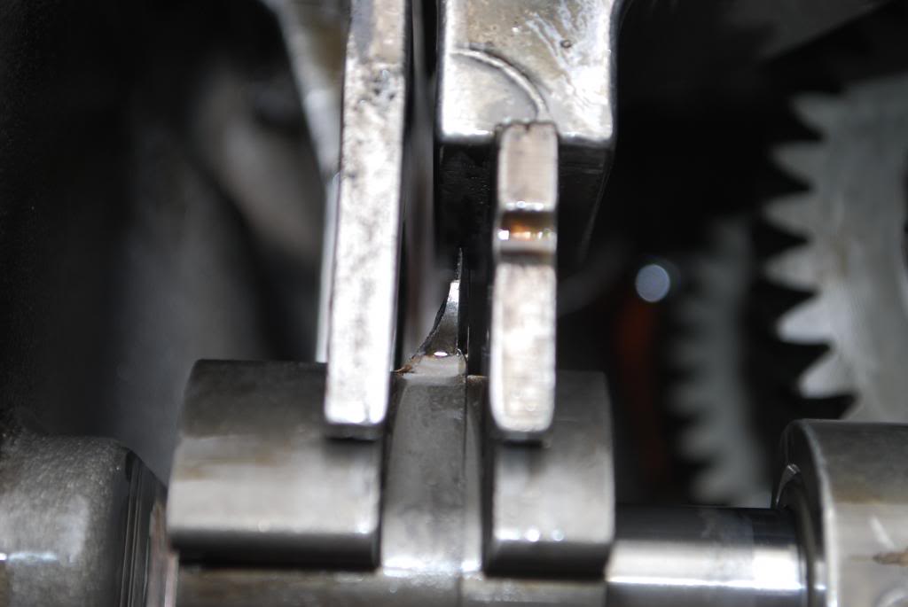

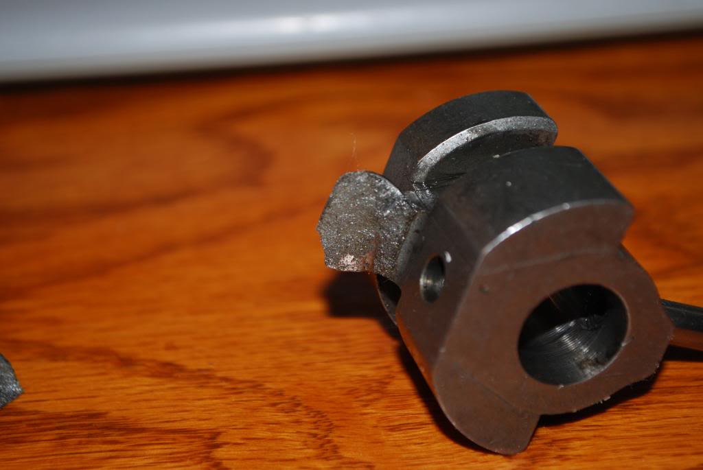

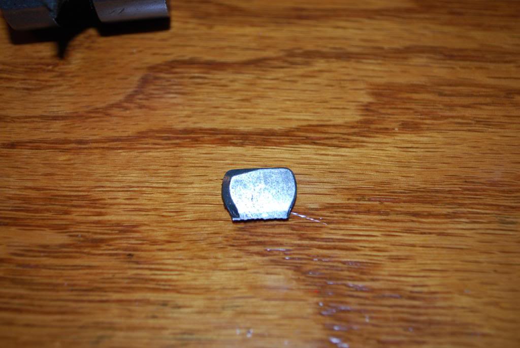

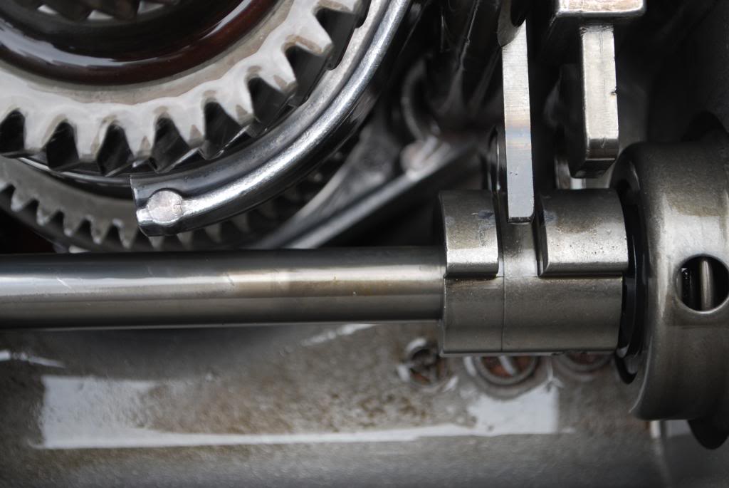

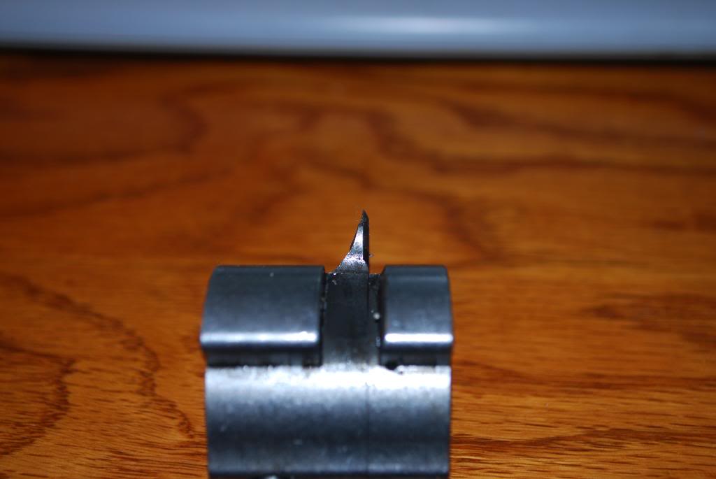

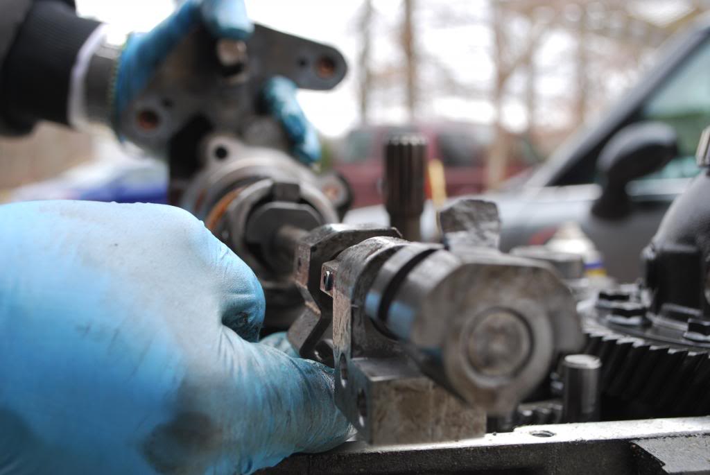

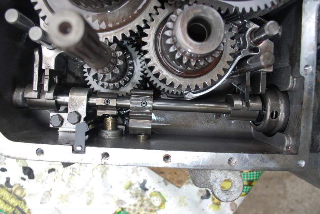

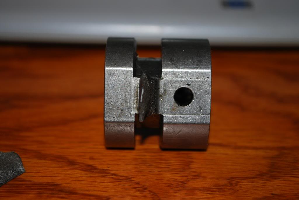

Well Found my problem! now lets hope i can fix it.
this is the selector for the 5th/6th fork and as you can see it is broken i found the broken part on the magnet. now all that's left to do is find a replacement or have a machine shop weld on material and cut it down. or have them make me a brand new part.
as i was playing with it to watch what was going on with the cover off the finger would go into the slot but when you went to turn the relay shaft it would just slide right out of the slot, so that's why i could not select 6th and why 5th would be troublesome some times.

I don't think I replied but please replace that guide tube. Even if you have to buy it at the dealer...you don't want to do this again for a 35 dollar part
Old Mar 27, 2013 | 06:09 PM
  #108
GreekDrifter91's Avatar
GreekDrifter91
Joined: Aug 2012
Posts: 1,021
From: CT
well hopefully this re-manufactured box has a new guide tube and seals.

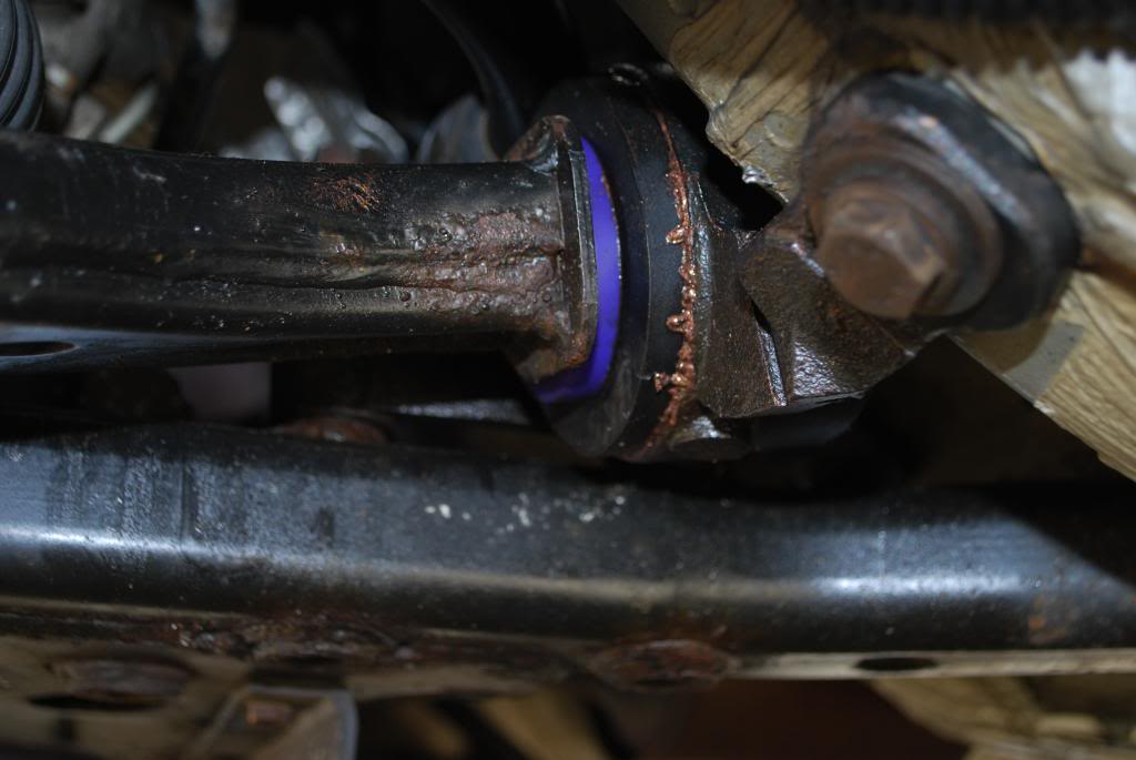

I also have the ABS and Traction Control light on and the TPMS light. any ideas what could eb the problem? code reader doesn't say a thing. i might have to go to MINI and see what there computers can tell me.

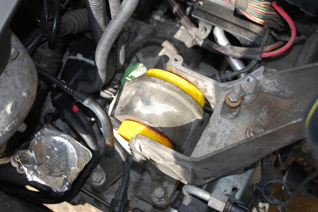

Driver side LCA bushing
Gear Box Bushing
Steering rack bushing
Passneger side LCA bushing
Lower Engine Mount Bushing

So how do all the bushing feel now?
Old Apr 4, 2013 | 08:10 PM
  #115
GreekDrifter91
Joined: Aug 2012
Posts: 1,021
From: CT
Fantastic! the car is so smooth and tracks very well, steering is very posative and it feels like you actual know where the wheels are going.
cant wait to put the upper engine mounts in! at the moment at idle its very minimal vibration. but when you blip the gas from idle to about 1000-1100 rpms its a little harsh but under regular drive no vibrations at all. power gets to the wheels nicely.
