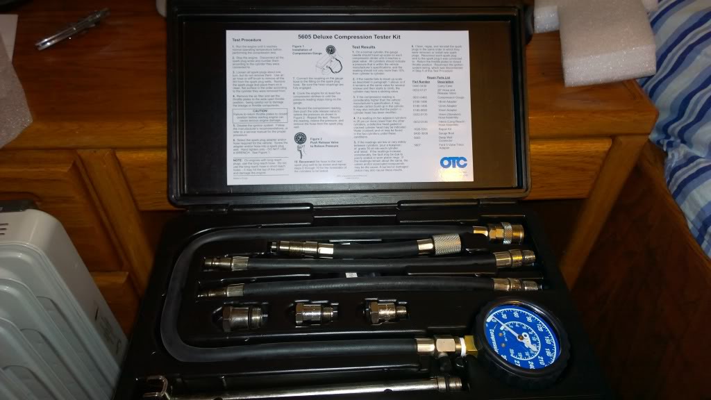

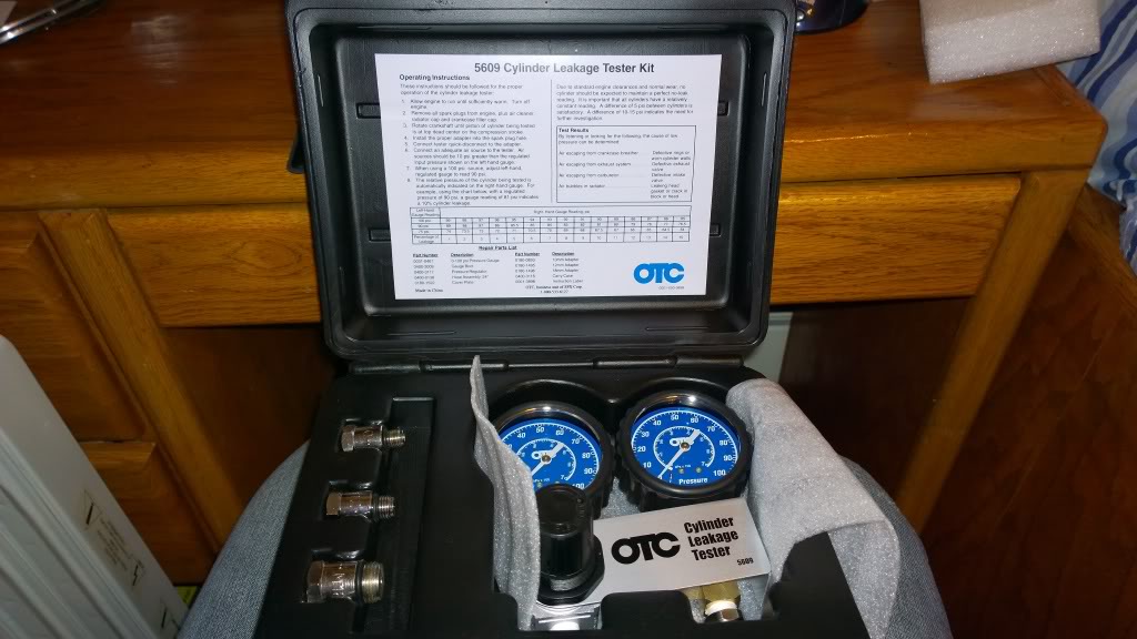

Some tools came in the other day.... just a few more things off my mechanics check list lol..... also my two oxygen sensors should be in today as well. i hope i will be able to install them tomorrow.
and because of this weird weather i had to apply a liberal amount of dielectric grease to my injector plugs because of moister problems. i was getting misfires and injector signal errors and it would ultimately shut down one or two cylinders.

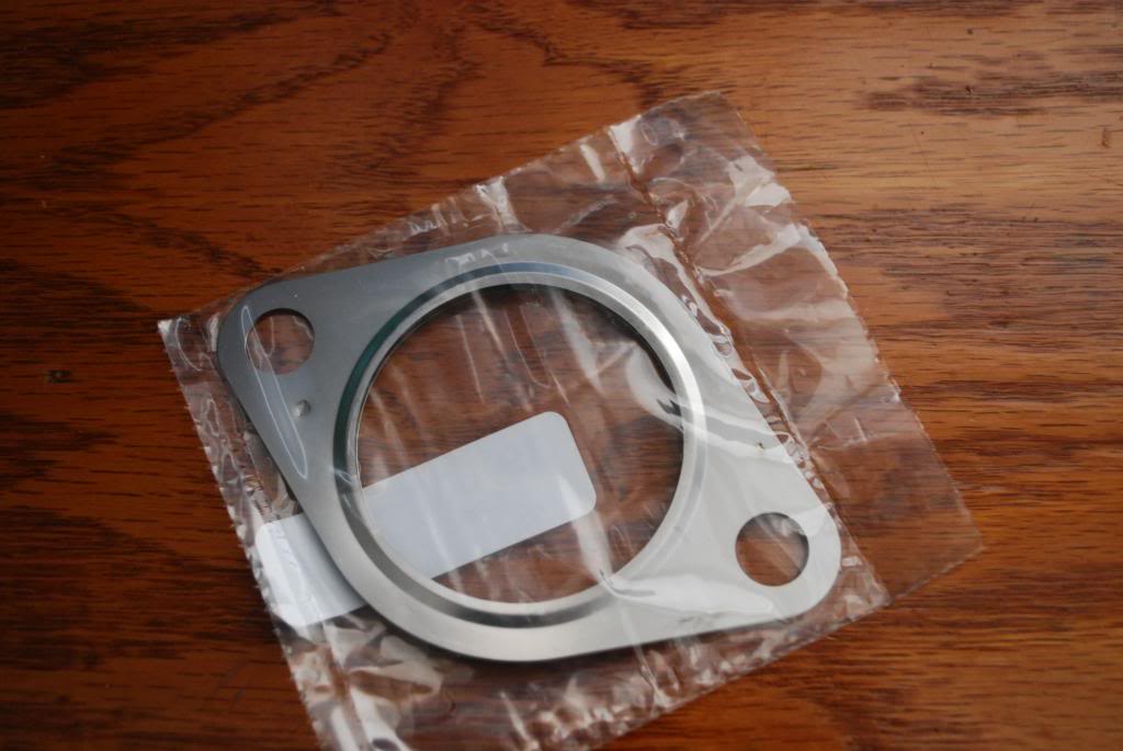

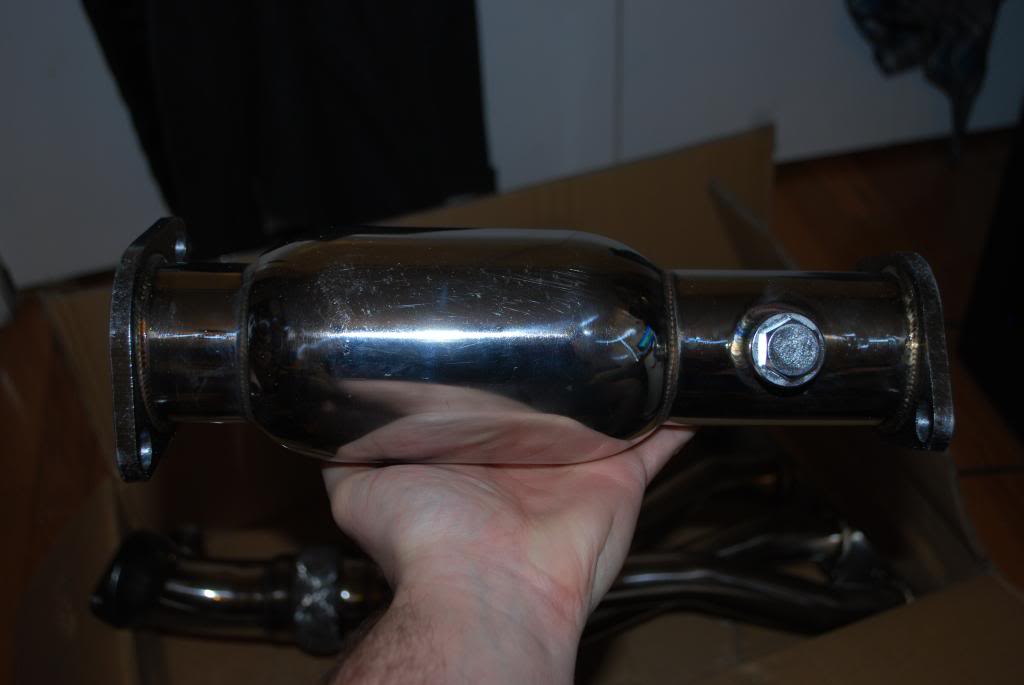

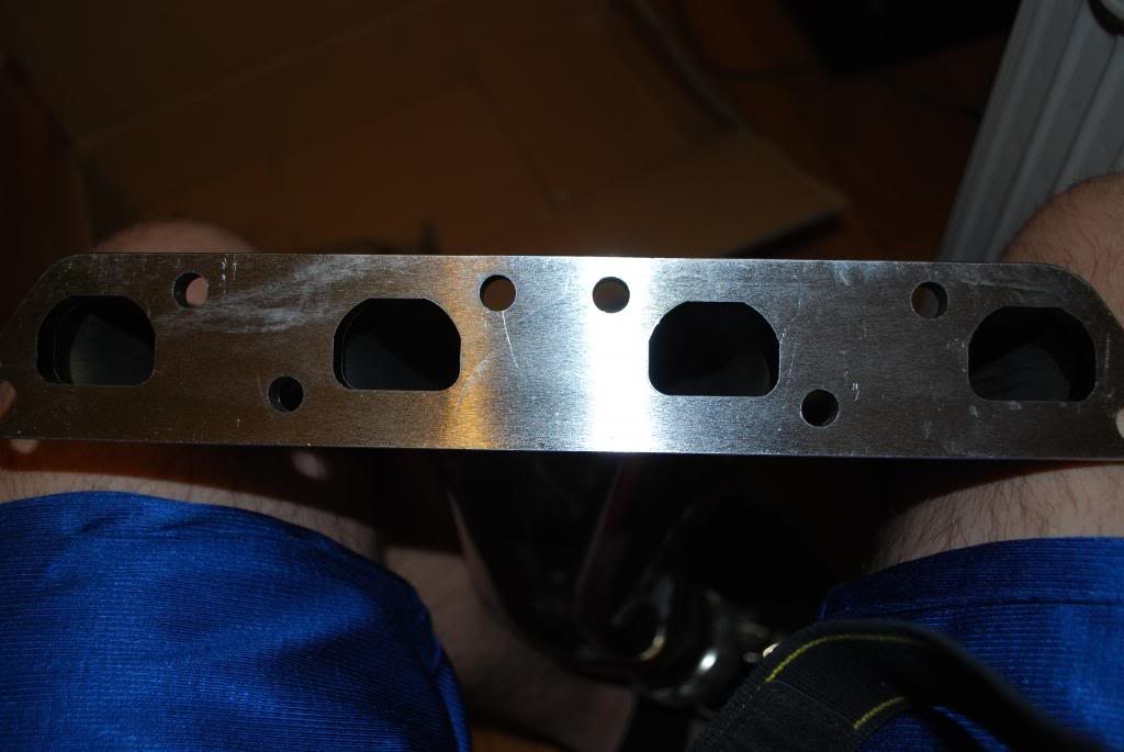

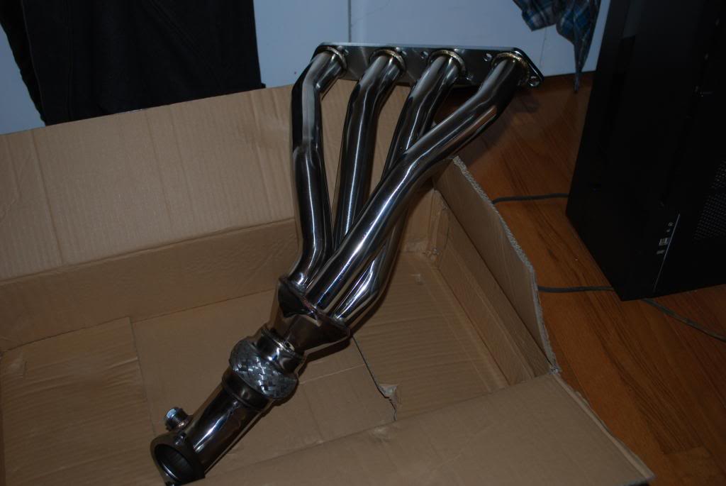

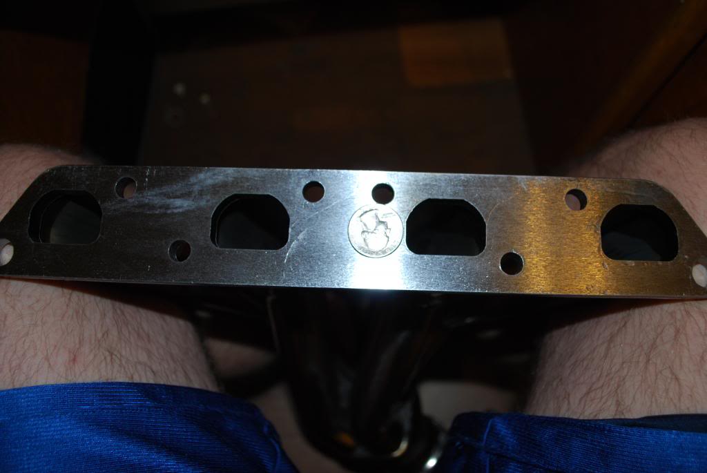

New parts came in!
Megan racing/M2 header and a mini-cat o2 spacer....
im gonna need opinions on this but i feel like im gonna have to hork out ton of metal on the ports. they look super tiny and the the ledge between the port and the runners is at least 1/4" maybe more. i also do not know how big the ports are on the head so im not sure what to do here. but the gasket is going to need some modding as well the ports dont exactly line up too well. over all thought the welds look decent and thats about it the stainless steel looks alright but wont look like that for long because next step is cermic coating. oh and im gonna get another bung welded in so that i can put in a wide band o2... also flanges are warped so gonna need to straight those out.

Old Jan 24, 2014 | 01:06 PM
  #369
SniperDetailing's Avatar
SniperDetailing
Joined: Mar 2011
Posts: 351
From: Shorewood, WI
Make sure you bolt that header up to your head before you do any coating. I ordered one off ebay that looks exactly the same down to the o2 plug-bolt and there were 2 or 3 manifold bolts that just wouldn't line-up at all
Old Jan 24, 2014 | 07:55 PM
  #370
GreekDrifter91's Avatar
GreekDrifter91
Joined: Aug 2012
Posts: 1,021
From: CT
Greaaattttt.... i knew these were cheap quality but i mean at least get the bolt holes right..
god thats gonna be a lot of work... but ill make it happen.... im gonna grind down those ports and get them welded form the inside too, while im at it. same with the two bolt flanges.
ill ask around in the megan header thread to see if anyone else has had that issue.

Looks like you might have had better luck with an OBX header. Mine bolted right up. Ports were good the flanges were flat and even. Only thing is it doesn't have a flex section to it.
Old Jan 24, 2014 | 10:49 PM
  #372
GreekDrifter91
Joined: Aug 2012
Posts: 1,021
From: CT
i just ordered a oem gasket and im gonna use that to see how well the ports line up as well as the bolt holes.
id rather have a 4-1 header with a flex pipe than a 4-2-1 with a ball joint.
plus i would rather buy a 200 dollar header put some work into it than buy a 1000 header and get the same results.

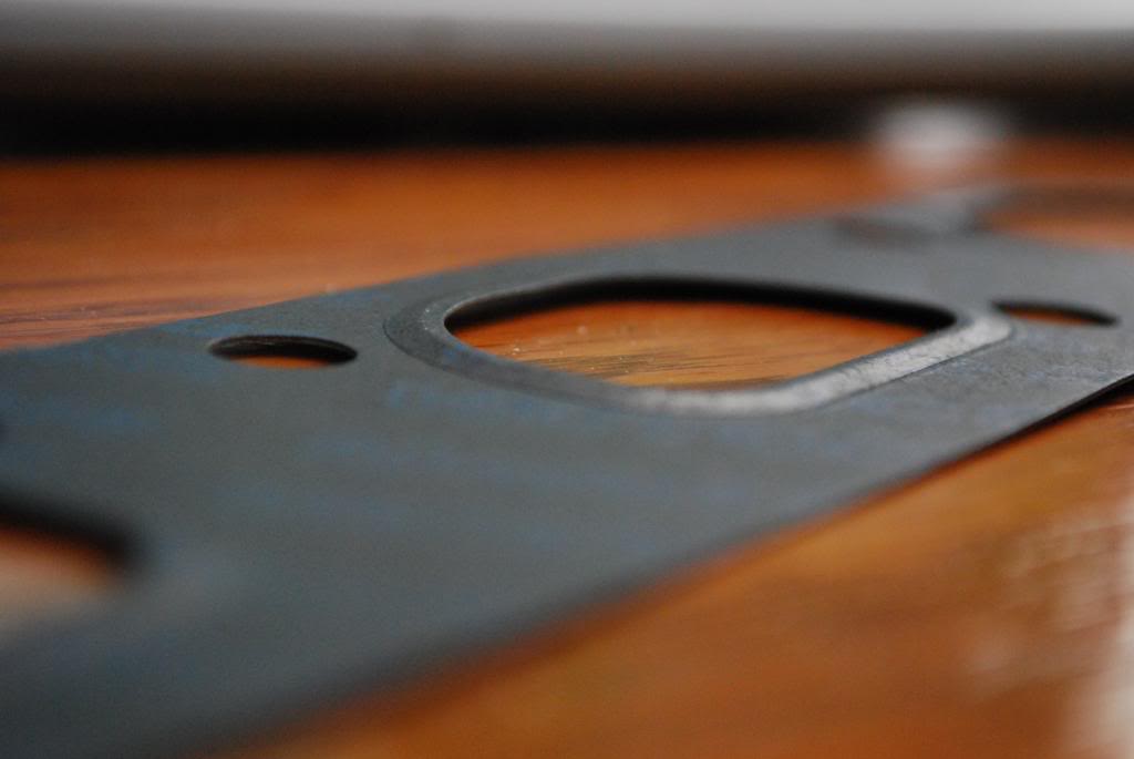

so got some gaskets in gonna see how well the bolt holes line up... intersting to see two of the holes are slotted.
also i have always been curios... are the manfold gaskets one one? are can thy go either way?
raised edge facing head? or raised edge facing manifold?
Old Feb 1, 2014 | 09:31 PM
  #374
Stoker's Avatar
Stoker
Joined: Oct 2012
Posts: 362
From: Fresno
"raised edge facing head? or raised edge facing manifold?"
That's what i asked Steve, he said it didn't matter cause they get crushed..
I put the raised edges "facing" the manifold, made more sense…
He showed me a trick, if you have a couple of ten mm bolts cut the head's off and use them in the two outermost bolt holes to align/hold the gasket in place, while your putting on the header. made life very easy since, the header is an awkward fit..
Old Feb 1, 2014 | 10:56 PM
