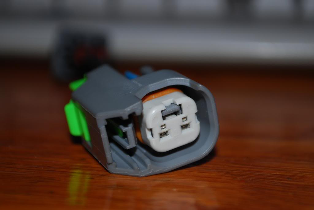

so after a long awaited drop off i finally got my injector adapters in ( USPS fault)
pretty fancy, maybe these will work better than the other ones i had. which were a little loose.

Loose? do you think that was why you were getting miss-fire's?

yes, im willing to bet it was those adapters. they were a bit loose. after loading them up with dielectric grease the didnt wiggle as much and they went away except for one cylinder would literally miss once in a blue moon, but it would always be at the most inopportune times.

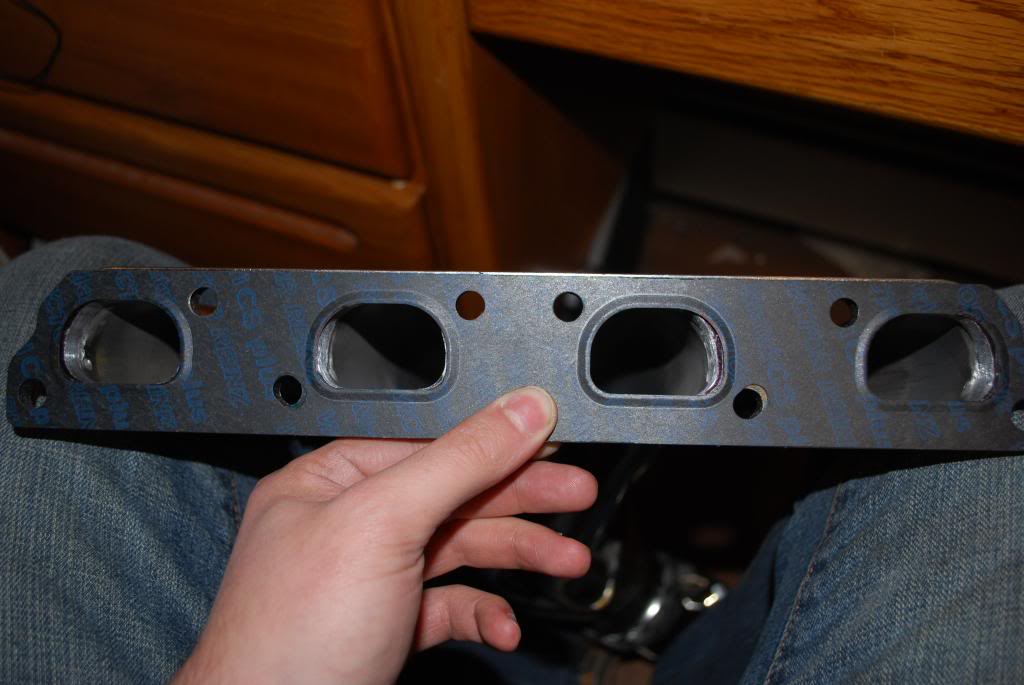

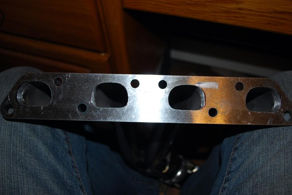

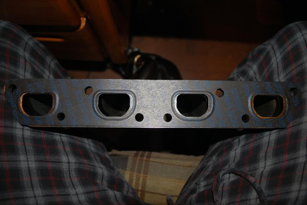

so i finaly got around to open up those ports tonight. looks like the runners and or flange are a bit off. I may grind down those small areas where the black marker is still. but beveled because im already grinding into the runner side wall i don't want to go more. and it still needs a bit of cleaning up
Also i maybe picking up a new project car soon. so this car will probably go on hold. money i was going to use on ceramic coating, cat-back, tune, and a catalytic converter will go into buy a car to turn into a race car.

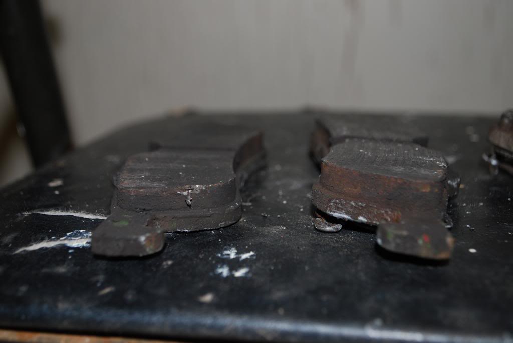

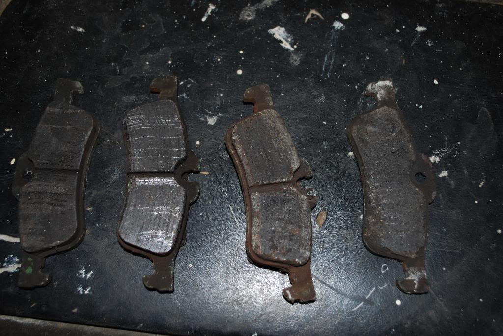

also PSA make sure to check your brakes. my rear brakes were seized again and were probably dragging all winter long. only saw it because i change to my summer tires all ready.
i have a feeling it was beacuse of the "brake stiffeners" i have had them seize up alot. so i just put in the OEM rubber slider holder things back in. now to just sit and wait to see if they seize again. i dont think so though. i have never had a problem with the front brakes so i left those in. and i put in a spare set of pads i had when i first bought the car and change over to the ebc green stuff pads.
there is like a 1/16 left of material left on that pad. both sides are cracked chipping away and or falling apart.

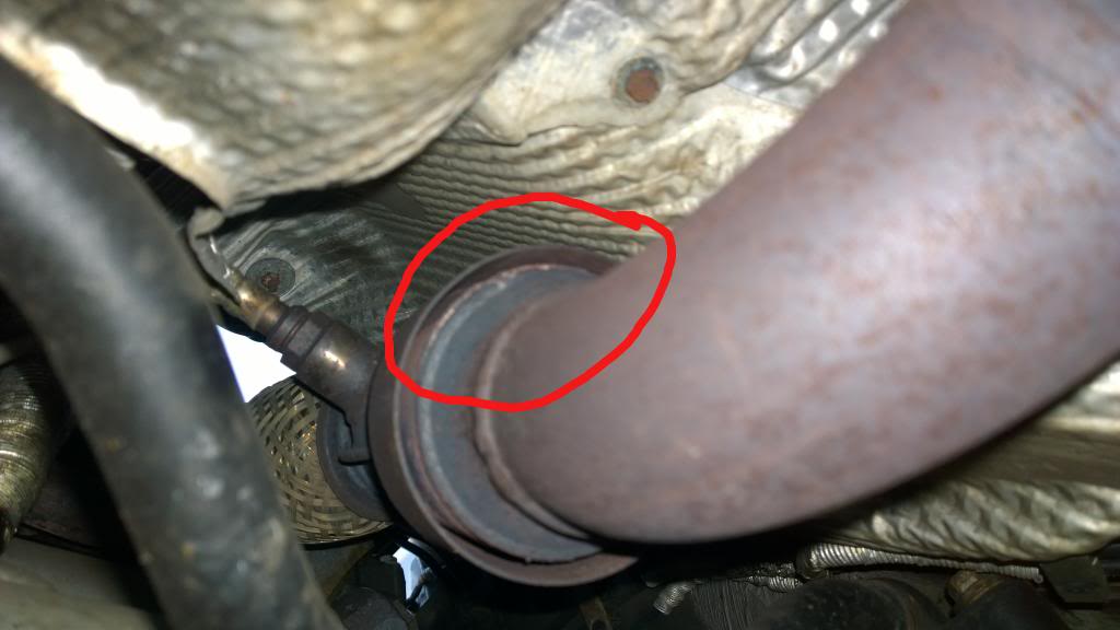

my Exhaust system fell of its hangers. and cracked the down pipe area after the collector on the header. and i don't have a another header to fix it with because i sold my Megan header to a buddy. So I ordered a OBX header and a Maganflow Cat those will hopefully be in soon. in the mean time because the crack was getting bigger. i used a bunch a patching kits to hold it over for now. it worked great on monday but today not so much looks like it probably broke free a bit. so when its cold the patch will leak but when hot it wont.

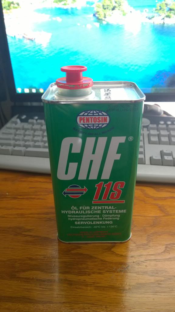

in other notes lots of parts and tools came in.
Power steering Fluid because i was running dangerously low.

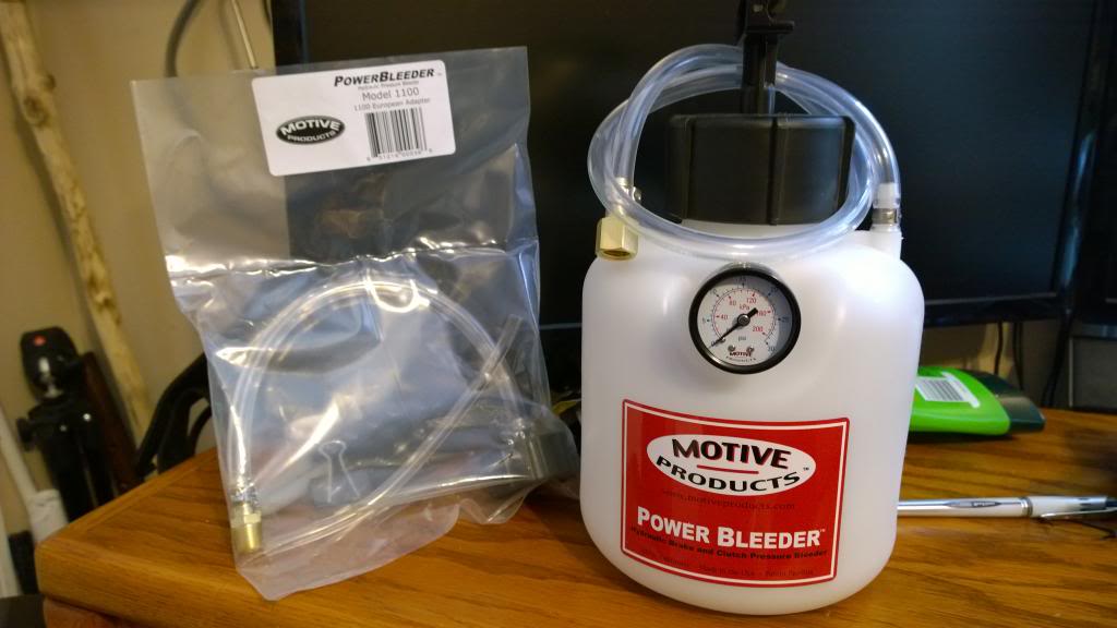

Power Break Bleeder.

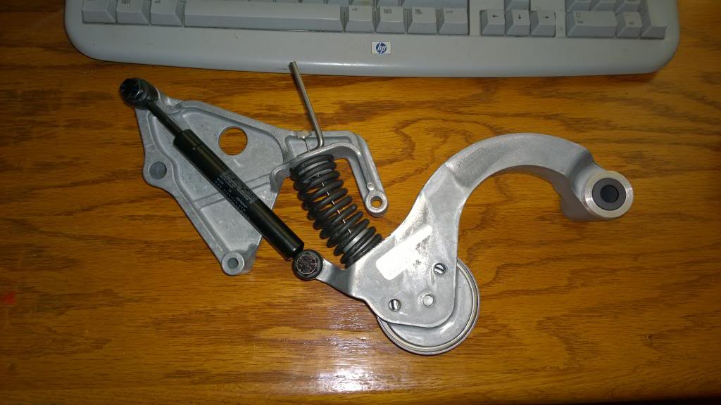

Gates belt tensioner assembly.

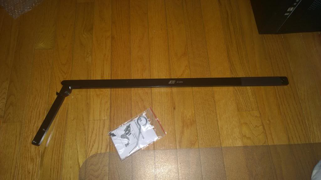

Belt tensioner tool. because im sick of doing it the cheap way.

You'll love you Motive bleeder, I have the same I bought a fire extinguisher too this week Seeing the list of cars that burned down on here... as well as assisting a guy whose car was burning on the side of the highway (calling 911 as I didn't had a fire extinguisher...)

yea i cant wait to use it i think i still have a bubble some where in the system. and i want to bleed the clutch line and im sure this will make it 1 million times easier.

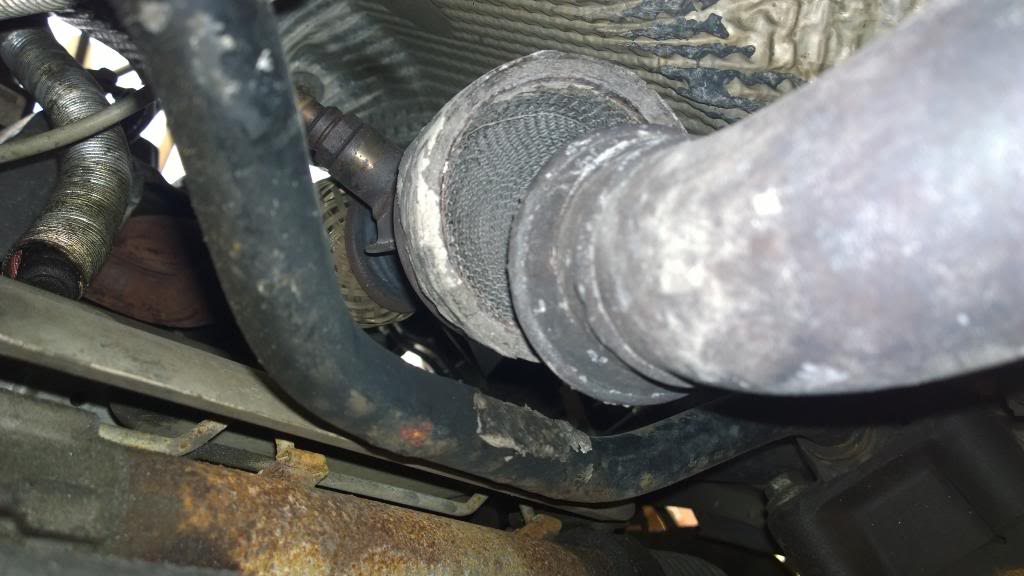

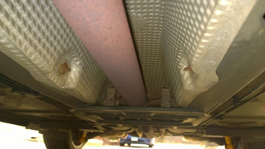

well the exhaust is completely broke now, it lasted a good 3 days with the patch.... that patch wont hold the whole system up the middle hanger was broken and its being held up by one in the rear and the cross brace in the middle.
on the way to work this morning (6am) on the highway it was nice and quite then all of a sudden AAAAAAAHAAHHHHHHHHHH... and i new what happened
so i now have a Alta cat-back that i ordered and am waiting on the obx header and cat thats in the mail.

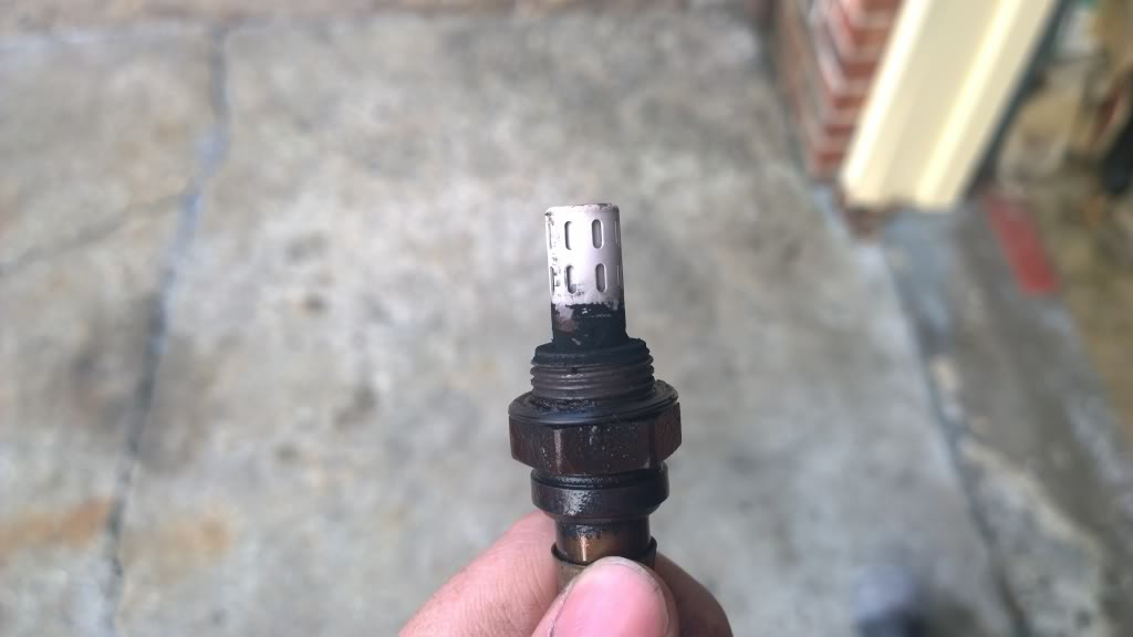

are o2 sensors "readable" like spark plugs? what does this guy tell me?
its the pre-cat o2

That's what my AFR sensor looks like, I asked about the white residue, was told "it's normal"..
