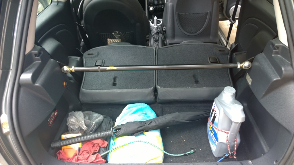

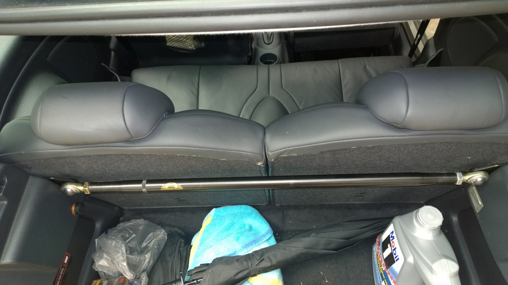

anyway here is the strut bar installed... it was super easy, looks good, and the seats are in their original positions.

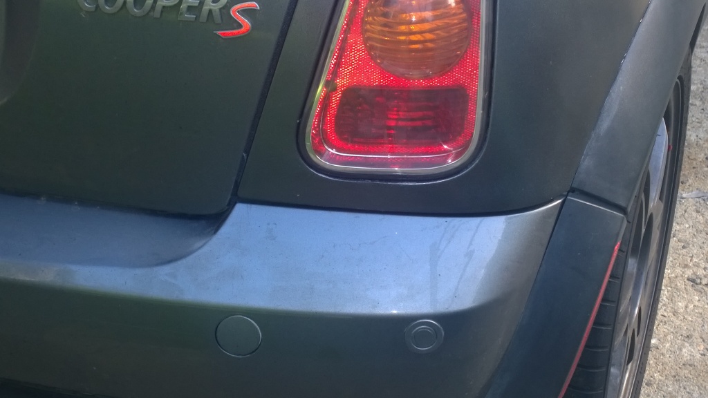

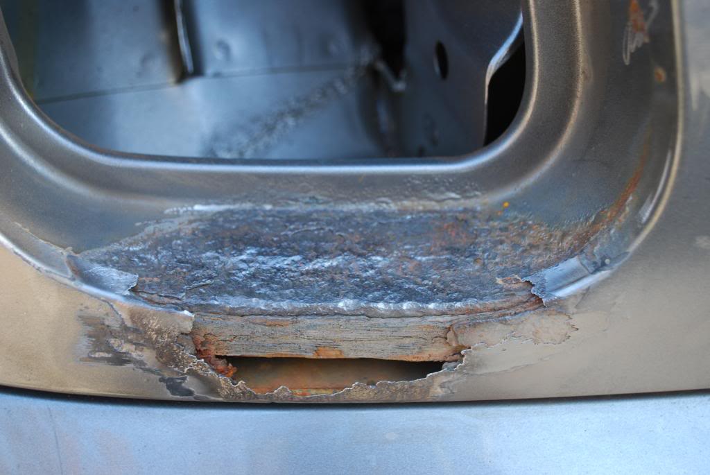

Also talking about getting things finally done i fixed the rust and painted the problem section i had under the tail lights. i got a spray can paint kit form a web site call paint scratch and the paint i got was a perfect match, i got three rattle cans of primer the paint and gloss. i just need to go over it with a rubbing compound to make it glossy and put some wax on it.

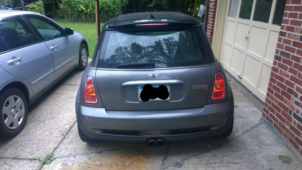

THE BEFORE..... it was actually much worse than this and had to remove everything there. and both sides were rusted.
to this.... and yes that is a broken tail light, my hand went right through it when i was putting it back in. i guess 12 year old plastic that has been weathered is very brittle. i have two brand new tail lights coming in as well as OEM mud guards.

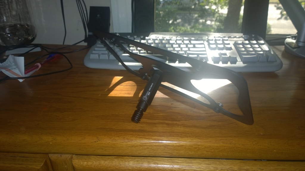

i bought a playtpus plate relocater. i took off my europlate. the fuz is cracking down hard on a lot of stupid things recently. know 4 people in 24 hours that got pulled over and got **** for no front plate. i dont need any more excuse to get pulled over.

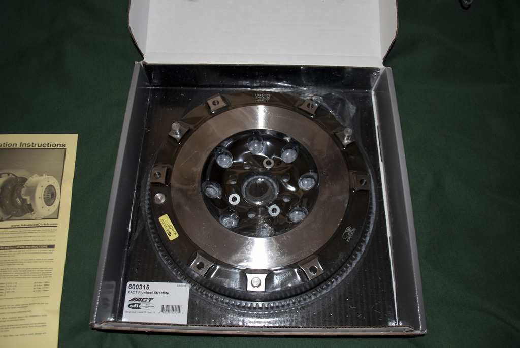

- ACT flywheel
- ACT Clutch kit
