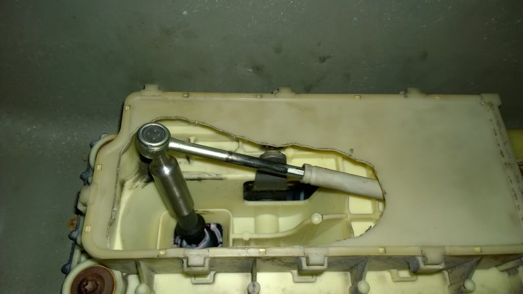

So i pulled out the rest of the Exhaust... and installed my Helix short shiftier that i had bought like a week after i got the car. i like the through cant wait to see what its like driving with it.
Cut out the cover for the linkage. was probably too generous with my cuts but htats ok, definitely got a total body work out today. put it in place, get out, move the shifter, go under take out cover, cut, go back under put in place, and repeat....

and i banged the heck out of the heat sheild, for it to fit with the new shifter. again probably to generous with the clearance but ill push it back in if the exhaust hits it.... i put the stupid thing in place, bolted down. i go up play with the shifter and i hear a horrible grind sound and a stiff shifter. im like uuugggggghhhhhh....

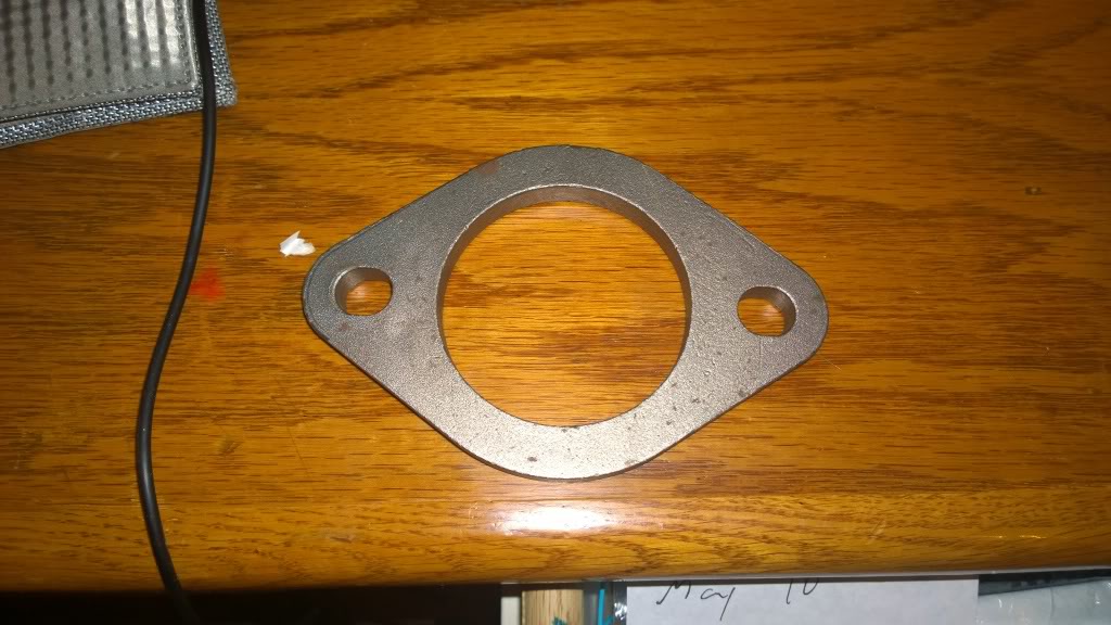

got a power steering pump fan mine is completely seized....
and i have a 2.5" flange for the cat...

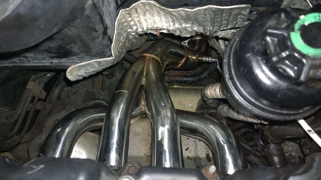

Also installed the obx header.... and man this was a huge pain in the as5 to put in. i had to remove the coolant tank power steering tanks and the bracket system that hold both.

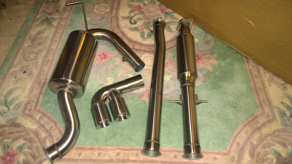

look what came in this afternoon!!! ill install tomorrow and mark up the flanges on the cat so i can get them welded.

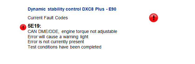

well exhaust is in and it sounds pretty darn good. a little loud. but man am i down on luck. i fix one damn thing and i get 10 others.... how the hell does all this happen with just changing the header back?!?!?!?!?!
O2 sensors are brand new.... may put the old ones in and see what happens. other wise i am at a lose...

based on this thread i will have to tkae a look at fuse F03 and i hope thats it...
https://www.northamericanmotoring.co...w-misfire.html

i figured out the problem thanks to that post. the wire on the rear o2 was indeed shorting out the system. had to take all day and two fuses to figure it out.
i unplugged it from the harness for now. so that the engine and ecu can run better.
now. i have a big Question. if i were to use an elbow on that rear o2 sensor to give it room and not pinch wires. would i get a lean code? any problems with fueling or power?

Dave perhaps a little re-reading is needed.... i had issues with the cat not the header. the cat i have looks to be just a tad bigger than the stock one so there is less room than normal. plus the post cat o2 location is different from oem as well. which causes even less room. on cat as opposed to on the pipe like the oem stock setup.
if you look at the picture above the pre cat 02 has plenty of room. and header has plenty of room. i have also read and experienced that you do indeed need to move the reservoirs when putting in the header. i just pushed the heat shield back so i would have more room.
and to be honest the obx header looks pretty solid. decent weld, clean bends. ports needed a little cleaning up. but were not to bad. and it fits just fine.
