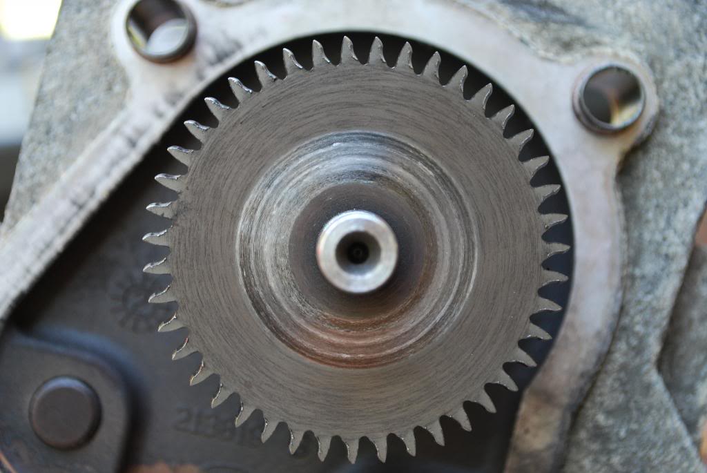

So i pulled my SC out this morning it its not good.... no oil and a ton of metal dust. the bearings are shot the bushing that holds shaft for the water pump gear is out of round. and the gear/shaft that turns the pump there so much play its crazy.
im gonna get a new or rebuilt sc just need to do some shopping first to see where i can get a good deal and if anyones got a warratny at all.

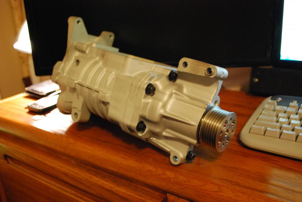

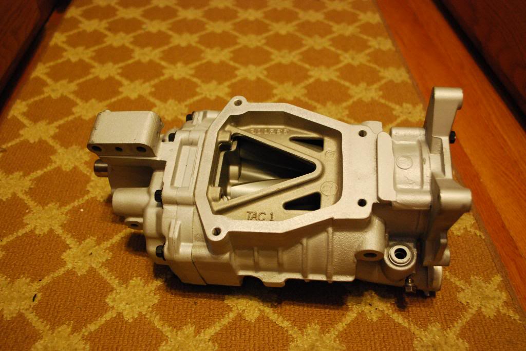

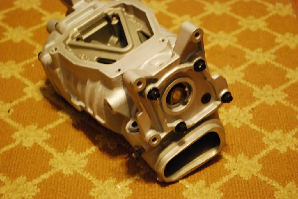

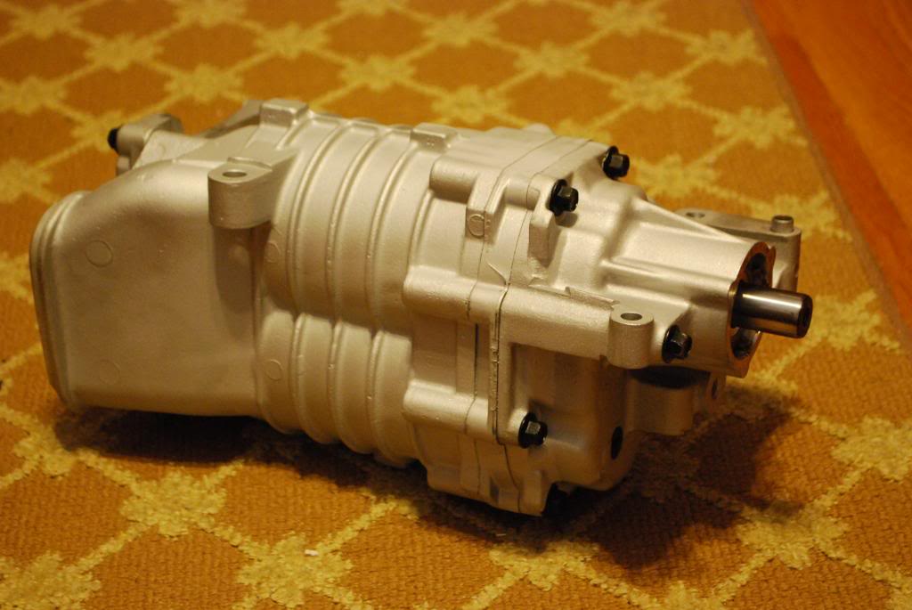

OHHH YEAAAAAA it finaly came in! unfurtunantly i wont be able to install untill sunday i have to go to work in 5 and working 12hrs tomorrow.

I got a rebuilt one form way. yea i should have any hassle getting it back in, taking it out was pretty easy. so fingers crossed it goes back in just as easy.
Originally Posted by astroBlackMetallic_Mini
Dude. You should take it to a machine shop, have them port it some, clean it up!
Since you'll have the car half apart anyway, take in the horns for porting too!
im all set with porting it ill leave that for when if and when i need a new head lol ill pick up a BVH and get the intake manifold/horns/SC P&P'ed
besides it been already been 17 days sense my car has been down it will be 19 days by the time i get it up and going again. i need the thing up and running already. winter is comeing and i need to put away my other car before they start to throw salt and the ground.
Put the pulley on gonna throw on horn and plastic intake then wait for sunday!

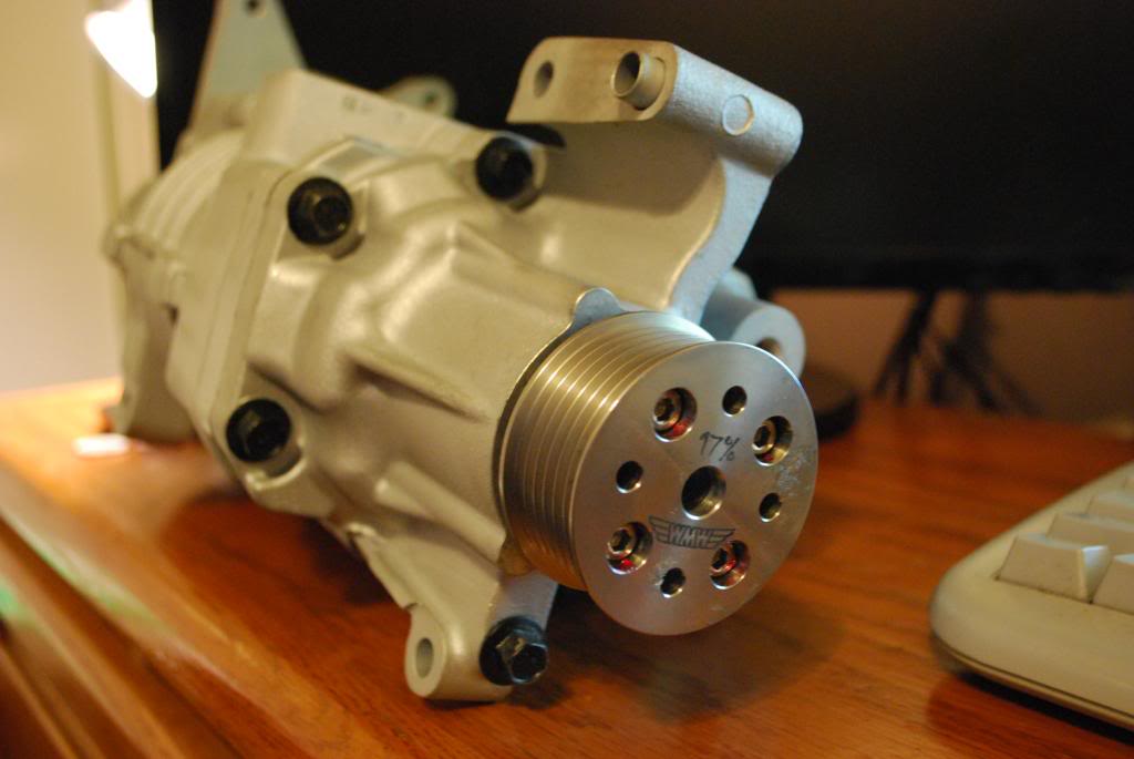

Oh man so excited to start to get my car back together tomorrow!
also look at the difference in seize between the stock and WMW 17%

I was just looking at the differences in general. The nose is not the same as your old one.
Sent from my Galaxy Nexus using NAMotoring

its the same. its just the camera angle, and the amount of oxidation the old one has that makes it look different.

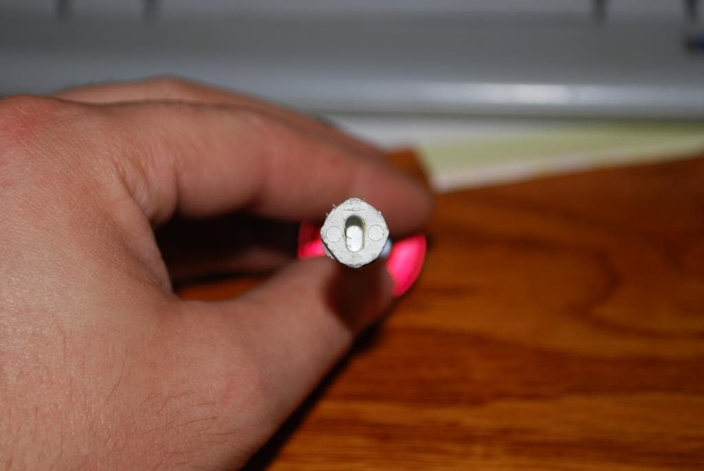

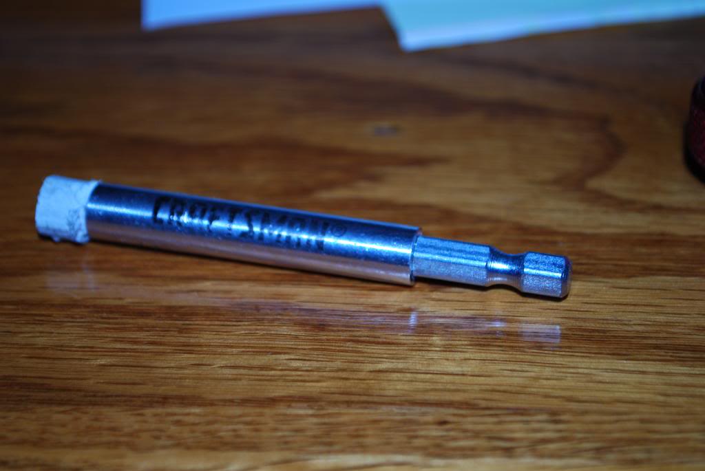

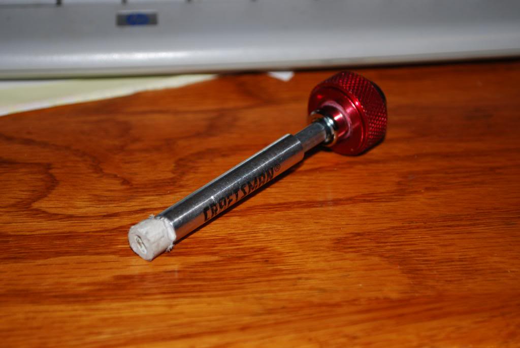

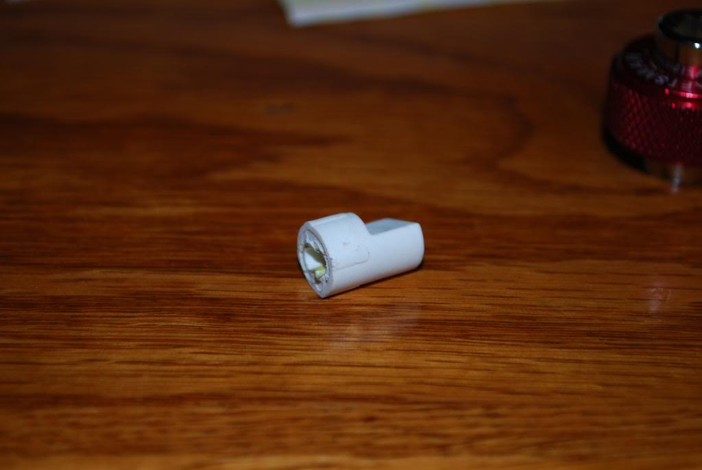

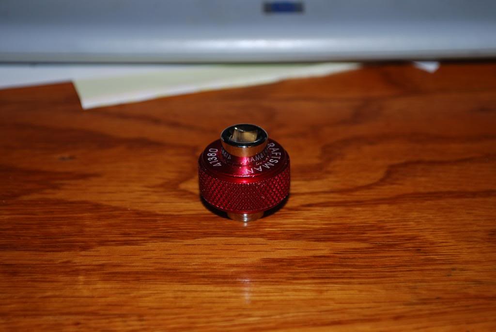

just made a sweet tool to adjust the dampers in the back, and the front too! but mostly the back. i found that you cant use the original too for the front if you are using camber plates the tool is too big but stock its fine.
i used a craftsman finger screw driver and a bit extension., then poped out the insert for the koni tool and shaved down the sides to fit into the hex bit slot. and viola it works!
Link to DIY..........

So you really like the Swift and Koni Yellows?
I understand it's only a slight drop with the Swift springs.
Do you encounter many driveways and the like that are too steep? Does the front valance ever rub on the tops of speed bumps?
Edit
BTW, your tool is cool. I like your suspension set up,.. Just wondering if you would recommend it to others, and if it is very streetable. For me its either that, or coil overs, I don't want it too low.
Old Oct 21, 2013 | 07:26 PM
  #298
GreekDrifter91's Avatar
GreekDrifter91
Joined: Aug 2012
Posts: 1,021
From: CT
well i couldn't give a good opinion on the matter because i haven't experience other setups, but over stock springs and blown shocks. yes, they are much better. The car handles very well and feels excellent for daily driving. i just want to tune it better i feel the rear need a bit more dampening so does the front.
the fronts drop 0.7" and rear 0.5" so its not much but it does drop it enough to make it look nice and fill in the gap. wasn't interested in "dropping' the car i need to be able to drive over things. and not swerve all over the road because there's a pebble.
and the spring rates are front 280lb/in(5k/mm) and rear 308lb/in(5.5k/mm)
as for drive ways no, speed bumps arent a problem either.

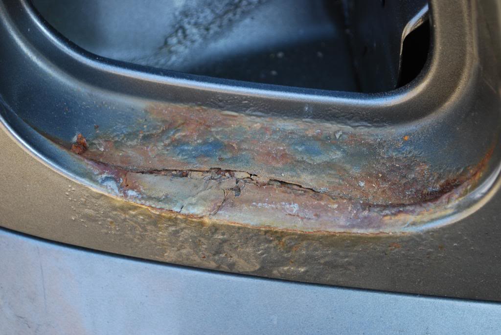

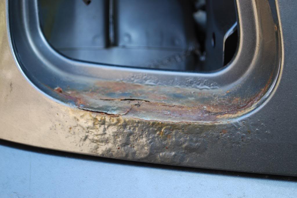

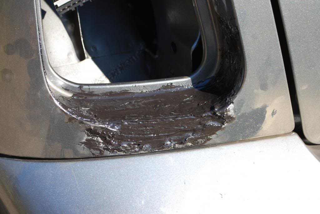

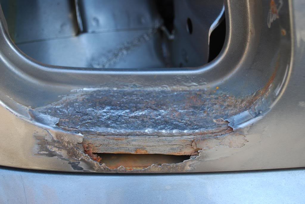

From: CT
So i tried the VGS mod today i like it so far boost builds up much quicker now, im still loosing boost some where though, i thinik its the boots so i had bought some alta boots they will be here some time today.
and i am tackling some rust repair.... i hate this stuff. ill finish up with some filler and paint tommorrow. i need to do some light repairs on the other light.
almost all cleaned up there was a ton still behind the paint.
then used some PRC to seal the area have to wait for it to cure befor i can put filler in. and sand it down.

these things are probably the hardest thing i have ever done on a car.
at least i am now seeing a higher boost level and it staying steady. still not seeing 17.5psi like i did when i first installed. but it may be belt slipage or the ultra gauge just being really slow to sample from the bus.
