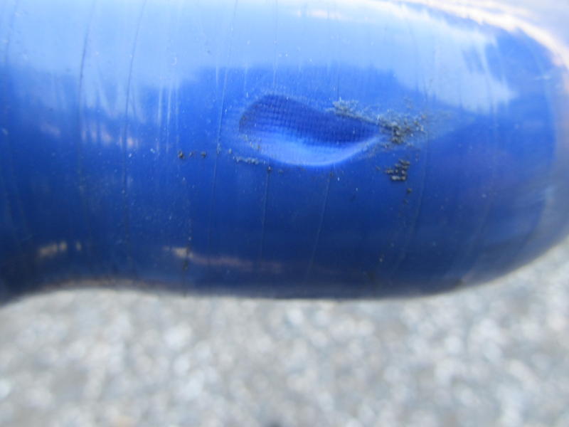

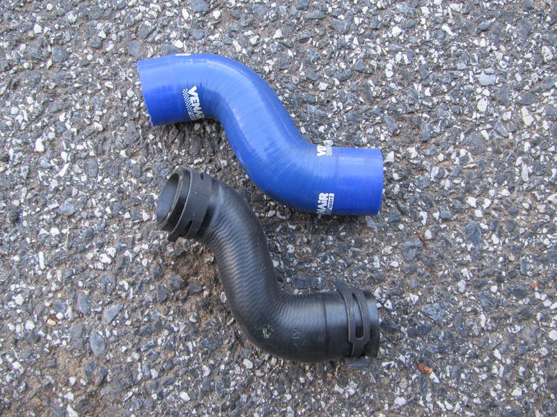

Hoping to save some MINI owners a hassle with this post. You may see those colorful silicone coolant hoses and think they are an upgrade. I did and bought some. They are advertised as longer lasting than EPDM hoses and, of course, they look nice! But don't get them. Nothing beats the OEM hoses for our MINIs. Here's why:
1. Fitment
This is the big one. A small difference of length and/or angle can be the difference between rubbing on something in the engine bay or not. The Venair set for my R50 was not off by much (see pictures), but it was enough to cause one of the hoses to rub on an alternator bolt, gradually gnawing into the hose. Thankfully I caught it before the bolt rubbed its way entirely through the hose.
The OEM hoses also include lines and markers to make sure you install the angle of the hose correctly. You don't get this with the silicone hoses.
When you buy new OEM hoses, you also get new spring clamps. These clamps are a pain to work with, but they do their job very well, keeping the same clamping pressure on the hoses despite changes in size and temperature. This is not true of the typical worm style clamps. There are special contant-torque clamps which work well, but they are expensive.
2. Water Permeation Rate
Silicone hoses have a much higher water permeation rate than rubber hoses - apparently 10-15 times higher. This means you will lose coolant through the walls of the hoses over time. Not a huge deal if you pop the bonnet to check your fluid levels at every fillup (as you should!), but if you don't check your levels regularly, you could find your temperature gauge shoot up out of nowhere from low coolant levels. Over time, this can also affect your antifreeze-water ratio.
Also, when I had the silicone hoses installed, I would always smell a faint coolant smell after driving. This disappeared after I went back to the stock hoses without touching any other components. I believe this is due to the higher water permeation rate.
3. Durability
Silicone hoses are often advertised as lasting longer than EPDM hoses. Perhaps it might be true, but OEM hoses still last a long time. I did not need to replace mine when I did - it was simply preventative while I had the front end apart. I very likely could have gotten at least another 5 years of reliable service out of my factory hoses (so a total of 10-15 years).
Also, the higher heat that silicone hoses can withstand is really unnecessary. If your MINI's engine ever gets to 375 F or 400 F, the usual high temperature rating of silicone hoses, the hoses would be the least of your worries. EPDM hoses are good up to about 275 F to 300 F, which is plenty.
4. Warranty
Many of the silicone hose kits do not include any warranty at all. The Venair kit did not. The OEM hoses carry 2 year manufacturer warranty. Something to always consider if an issue does pop up...

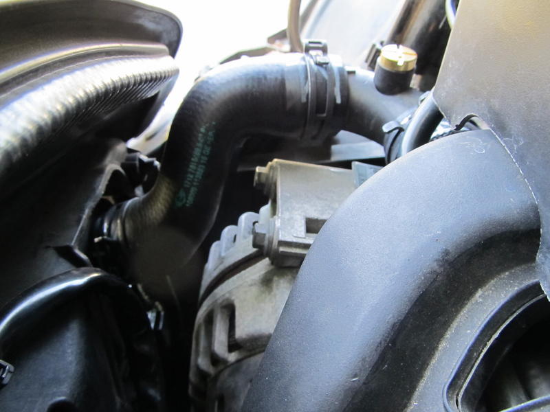

More pictures. Notice how perfectly the OEM hose fits over the alternator. Not true of the silicone hose.
