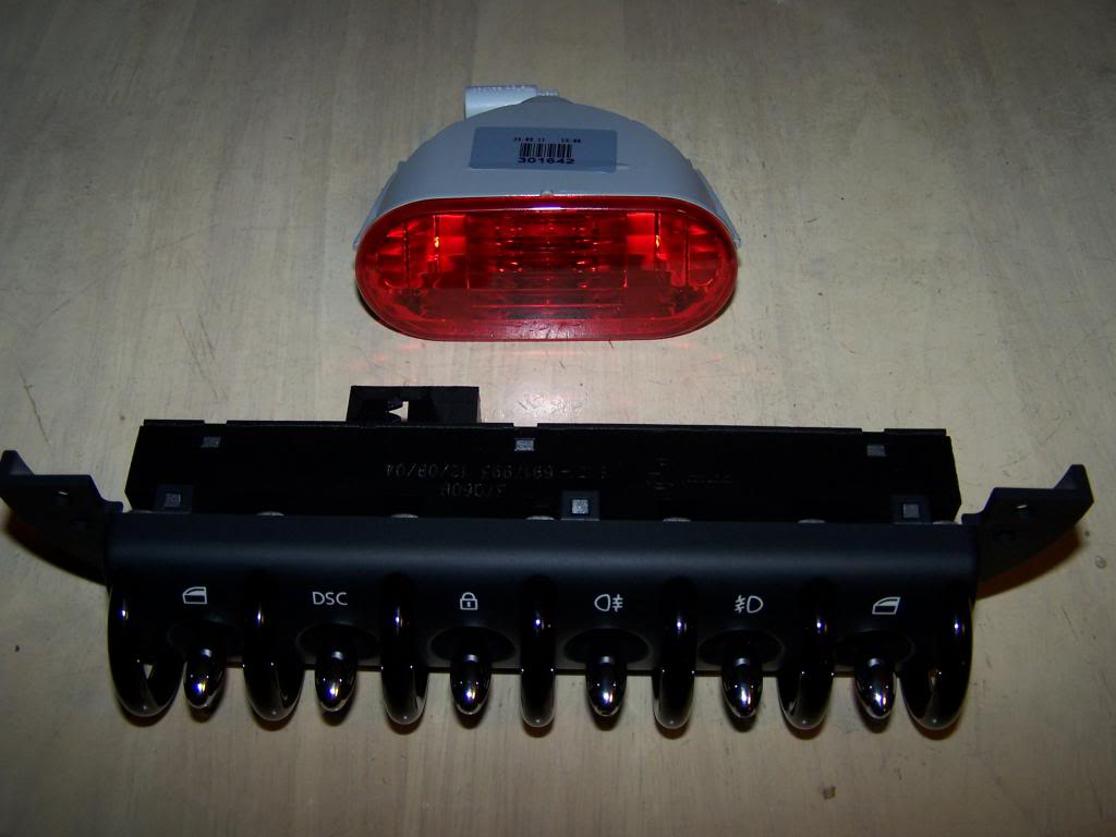

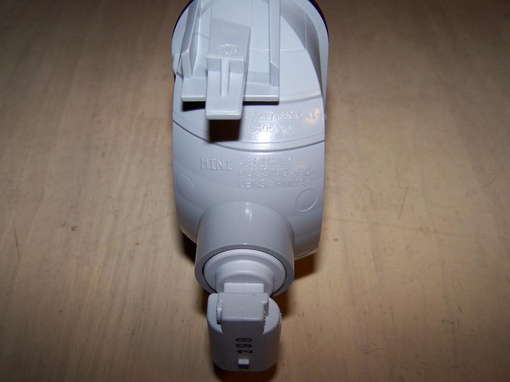

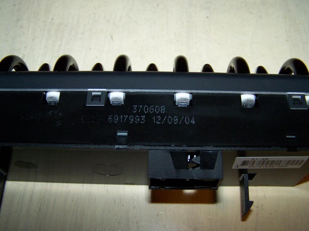

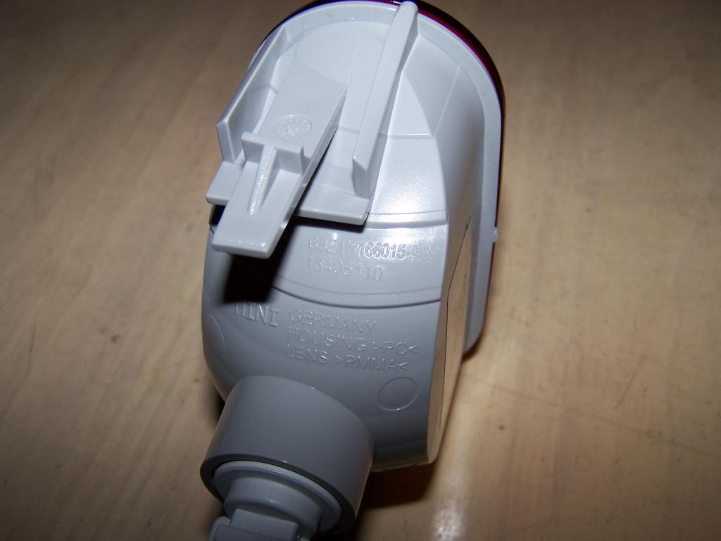

After alot of research, I ordered the correct parts to get the rear fog light installed in my '06 MCS. The '02-'04 models don't need a separate rear fog light installed, as the top lights in the factory tail light housings are what light up. However, I had to order the rear fog to go where the reverse light used to be. Now all I have to do is go to the dealership to get the function programmed into the ECU.
Here are the two part numbers needed:
Rear fog switch bank, ALL switches, DSC: 61 31 6 917 993 (61316917993)
Rear fog light housing, red: 63 24 7 166 015 (63247166015)
Here are some pictures of the parts ordered:

You can order the parts from DDM tuning:
http://www.ddmtuning.com/Products/BMW-61316917993SWITCH-UNIT-CENTER-CONSOLE613010 (DDM part 613010)
http://www.ddmtuning.com/Products/BMW-63247166015REAR-FOG-LIGHT631410 (DDM part 631410)
A couple of notes. First, DDM tuning has the switch bank OEM part number wrong. The 5th digit is wrong; 61 31 9 917 993 (61319917993) is NOT correct. Second, the rear fog light housing part number I stated earlier is correct. However, the actual part I received has a different 4th digit; it shows 63 21 7 166 015 (63217166015).
