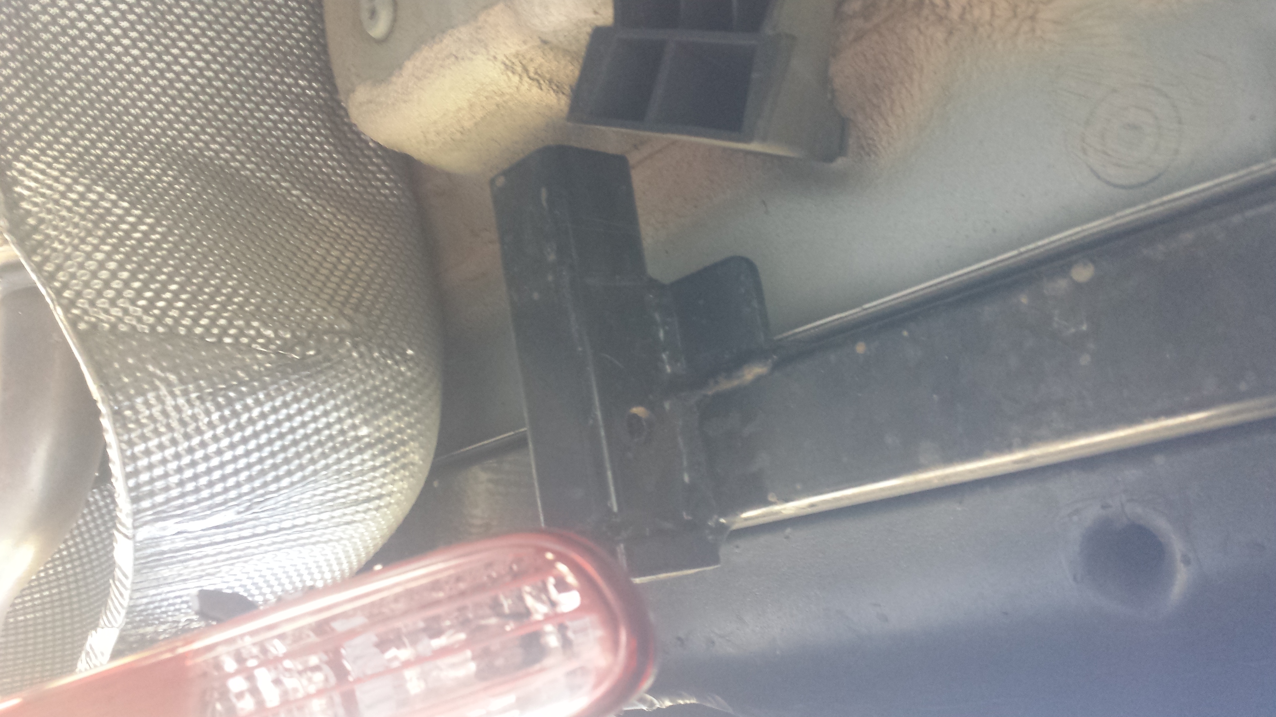

Ok, turns out that my car actually has a tow hitch behind this light and the top tabs have been cut off from the inside of the bumper cover. I guess I need to find something to tow then....meanwhile, I think I'm gonna get the led bulbs and ziptie the light in place.

Could probably just spot double sided tape around the bezel. Zip tie might not get it tight enough where it doesn't rattle.
