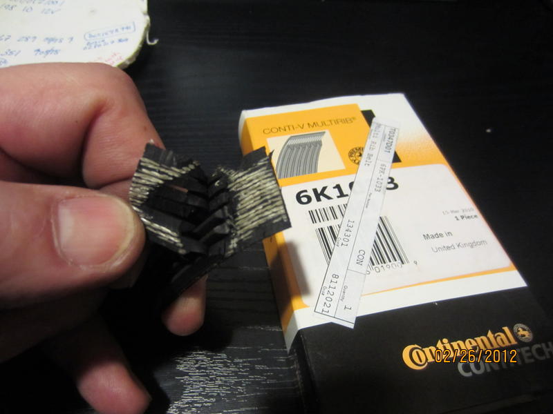

Old Feb 26, 2012 | 11:05 AM
tberardi's Avatar
tberardi
Joined: Feb 2011
Posts: 82
Originally Posted by ZippyNH
The belt is fabric....it is NOT STEEL REINFORCED.
If frayed, and it brakes, big $$$ to replace the rennsioner and the crank pulley, due to the failure of a $20 belt...think $1000 in parts plus install, plus a tow......
Zippy is correct. The belt is not steel wire reinforced. My error.
To confirm, I cut apart an old belt I changed from my MC ( i keep the old ones for various odds and ends) and found it to be reinforced with some polymer based strands. Refer to the attached photo. I would agree that you should refrain from driving the car depending on the degree of fraying but be safe rather than sorry. Change the belt as soon you can and consider doing it yourself. Its relatively easy.
