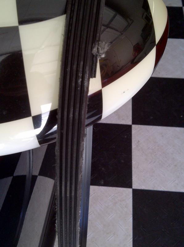

SUCCESS! This morning I completed the removal and install of a new belt. I didn't purchase the Mini tool but was able to rent a universal serpentine belt tool from the O'Reilly's in town for free.
using a socket on the nut as I read in other DIYs I was able to untension the spring and remove the belt.
As you can see in the pic basically one line of grooves had torn off the belt.
Yoda - 1 Stealership - 0
