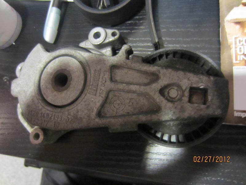

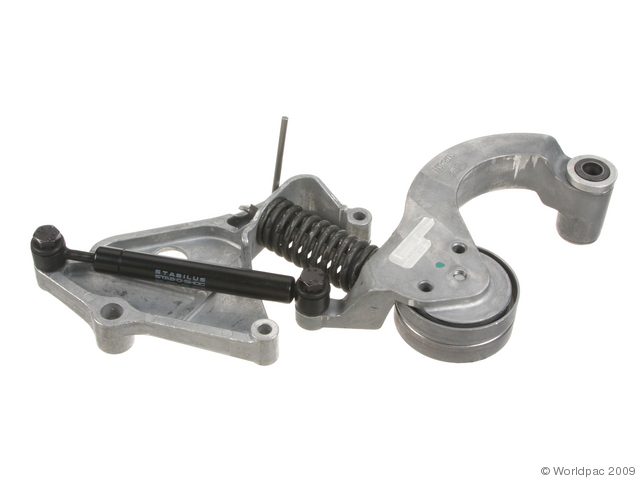

No disrespect but I have used this tool for 4 years on all my cars. Never felt flimsy or weak. Heck, you would have a tough time breaking the 3/16" thick steel even if you beat it with a sledge hammer. Plus the special tool for the mini appears to be of the same basic design and steel thickness. Plus, its only $20 and it does not take that much force to turn the tensioner.
Anyway, I have attached a photo of the MC tensioner that I replaced last year showing the square hole where the tool fits into and turn to relieve spring tension so you can R&R the belt. Simple enough.
You can also use a ratchet and square head socket as was previously suggested if you can fit it in there and it would avoid having to buy a special tool. Your choice.
Update, I went online to see if the tensioner for the S is different than the MC. It is. see attached photo.
Based on this design, I cannot see how the tool discussed above will work unless you can make something to fit into the two holes to enable to turn it. Sorry, you will have to look for an alternative such as the specially designed "Cooper S" tool at a greater cost. daflake posted a good source. Still cheaper than paying someone else do it for you and you will own the tool for future use. I say go for it.
Based on this design, I cannot see how the tool discussed above will work unless you can make something to fit into the two holes to enable to turn it. Sorry, you will have to look for an alternative such as the specially designed "Cooper S" tool at a greater cost. Still cheaper than paying someone else do it for you and you will own the tool for future use. I say go for it.
Don't know about the one you have but I have seen the Harbor Freight tool and it isn't the same quality as the MINI one. The sockets were also cheap and known to break and even the reviews on their site claim it breaks. The one that I have seen was pretty cheap.
As you pointed out it won't work anyway, so it is moot.
