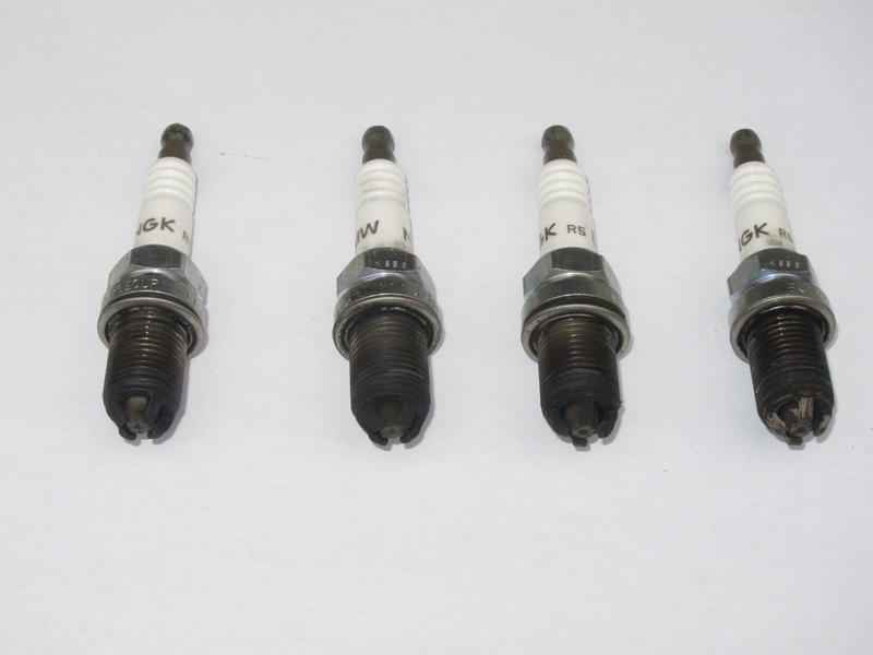

I have a 2002 cooper s with about 176xxx miles. Sometimes I notice a hesitation during acceleration (around 2000 - 4000 rpm) and erratic idling every once in a while. Ive read about people replacing spark plugs to fix this so I decided to take out my spark plugs and see how they looked. Immediately I noticed that they were very uniformly black.
Im not sure but Im guessing this shows the car might be running a bit rich? Also I do drive mainly just around town (with lots of stop signs) and usually for short bits of time.
What do you think?
Note: the spark plugs in the pictures are arranged 4 3 2 1
I did scrape the #1 plug
Thanks a lot for any insight

They look fairly normal actually. They do look like it is time for a change. I recently had hesitation as well and put some new ones in on my 06. You will notice a huge difference...
How many miles on those plugs?

Yeah, then swap them and you should notice a difference.

I'd go with the NGK Iridium (one step colder) rather than the JCW. I have been running those plugs for a few years now and they are great.

To get a really good plug check, the engine should be at operating temperature and a clean cut (WOT under load and shut off) executed. It does show that you drive the car as described as the core shows a nice tan color but the tips are black. New plugs should help but I would really consider the same heat range given your driving habits, colder plugs are better for higher speed driving. Warmer plugs are better for stop adn go driving and will fire off better if a lot of cold starts are typical. Colder plugs will foul easier.

I believe you have normal wear on your plugs. Our Brisk plugs are on sale right now and are a good choice for daily driving duties and track use. We have not seen an issues with 1 step colder plug fouling in the MINIs but Dw1 you are correct the colder you go the easier they foul.
