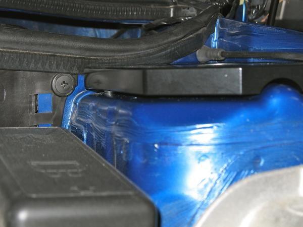

This is how the plates sat without bolts. The initial install doesn't really pull the towers into place too much. They just seem to gradually settle into place when driving, and the nuts barely move when re-torquing. My plates sit nice and flush now, but I still check the torque periodically as part of my oil change interval. They haven't move at all lately, so I think everything has settled into place.
I would have kept re-torquing them even if I pounded them down first. You might go too far and the same would happen with the nuts losing torque over time.
