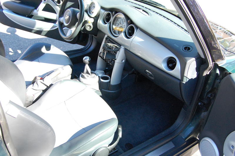

Old Nov 1, 2011 | 05:31 PM
TLO03's Avatar
TLO03
Joined: Sep 2011
Posts: 11
Well its been finished for a couple weeks , heres some updated pics.
Attached Thumbnails New Mini owner-dsc_0479.jpg   New Mini owner-dsc_0488.jpg   New Mini owner-dsc_0467.jpg
