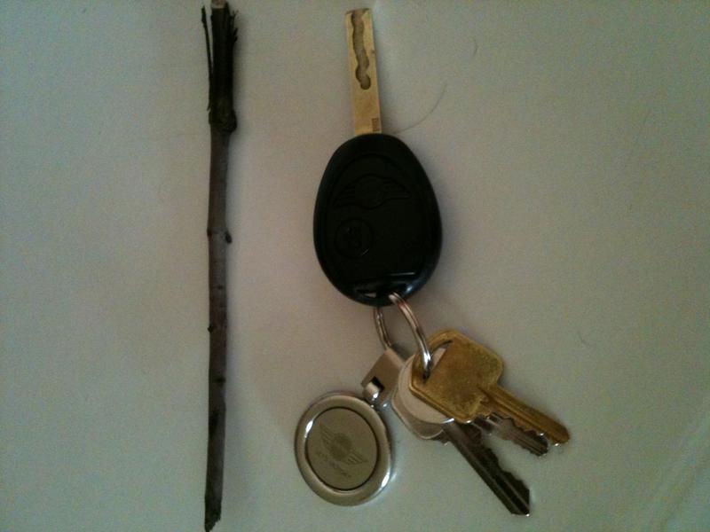

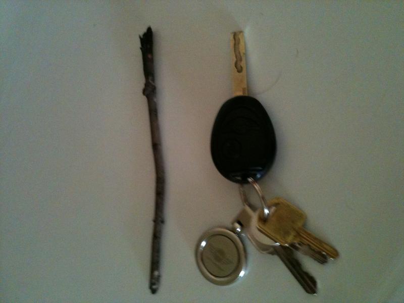

So, I was finally able to get my tires off to take a look! Know what I found? A piece of twig stuck in my caliper!! Needless to say it was rubbed smooth in areas and scorched in others.

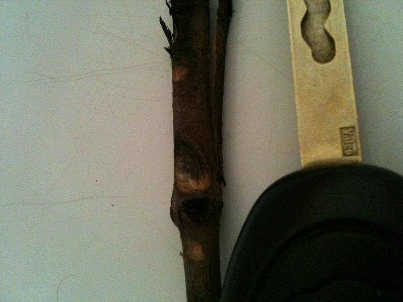

And this one. Now all I hear is smooth tires and pavement
