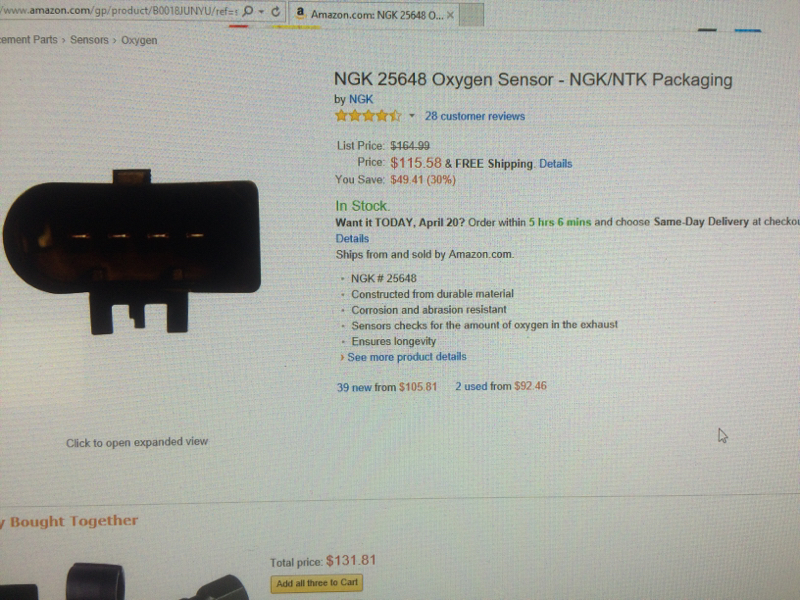

Will this one work?

Is there a part number listed? NTK part number for O2 sensor that you'll want is HERE.
