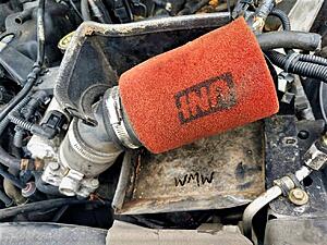

Zombie bump thread provides perfect oppo to share a pic from a junkyard in NC that I visited while working there and came across this cool WMW R50 intake,
I didn't get it but I did snap a photo:

WOW that is at least 10yrs old. I wonder which of our customers it was. Should have snagged it a new filter and that would have been a deal for an R50 owner
