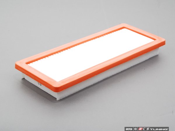

Genuine MINI filter - stock part 13717568728
http://www.ecstuning.com/Search/SiteSearch/13717568728/ES35246/
Mahle MINI Filter - stock part 13717568728
http://www.ecstuning.com/Search/SiteSearch/13717568728/ES2631451/
