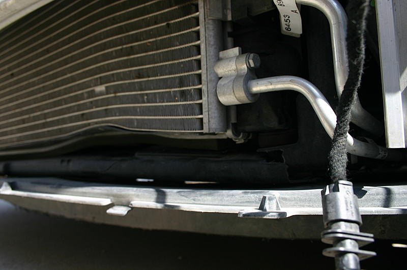

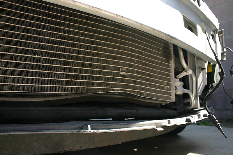

So, three days ago i was driving home in traffic on a side street. Out of nowhere a huge bright orange sand bag appears in the road ahead. Of course all of the large vehicles in front of me passed over it no problem, but my mini was a different story My ac condenser and radiator took a pretty bad hit along with the radiator support. Now, i did not notice this untill today when i took the bumper cover off to inspect for more damage. I drove the mini two days without leaking, overheating ect..
Im thinking about usinging some gorilla glue on the radiator support... but im not sure if i should drive the car with the radiator and ac condenser smushed if I should replace these, do you recommend me ordering the parts and doing a DIY?

If the condenser is not leaking, then I would not bother replacing it. You've only lost a small fraction of the total fin area and you wont have any problems with reduced capacity. If there ends up being a leak, the system will shut down to prevent damage due to lost refrigerant. By the looks in your pictures, you have 'soft' damage to the condenser, where there is a gradual bend in the bottom-most tube and some crushed fins, rather than a hard gouged-out chunk of metal with more potential for leaks (as would happen if a rock hit it).
The radiator support can be fixed with some serious glue, or it can be replaced. If memory serves, you can actually finagle the radiator and condenser from the plastic support (also known as the modular front end) without disconnecting any coolant or refrigerant lines. This plastic piece is not structural for the body, rather it just holds the two cores and some smaller bits in place.
