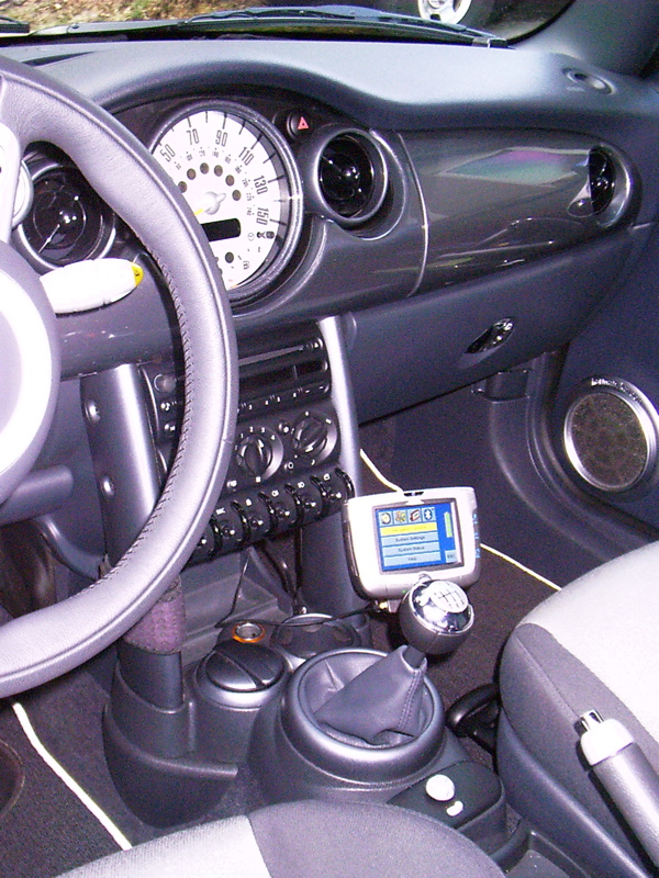

Proclip and Magellan 6000T working well
hi All - I have had good luck with the Proclip angled low mount ( Link Here ) to which I mounted a ball/swivel joint and the factory-supplied Magellan cradle for the 6000T. The swivel joint lets you adjust the viewing angle of the screen through a pretty good range. I got Item No. 213018 "Tilt Swivel Mount" also from Proclip.
The ProClip mount attaches to the passenger-side downtube with some 3m adhesive tape. It DOES interfere with the glove box opening IF you place it too high. In the position I chose the GB door stops about 2" higher than normal, which for me was not a big deal. You can press-fit the clip before locking it down with the adhesive strips, which you probably want to do.
The GPS does not get good reception on its interal antenna in this location, which I anticipated from some SOTP testing. I bought and routed an external antenna along the passenger-side dash along the bottom of the glove box and up to the passenger side A pillar. I secured it with a 3M removeable mounting square. It's inconspicous and works great - see upper right of photo.
I chose the 6000T for the BT speakerphone and for the built-in traffic updates. I also like the real buttons as opposed to only a touch-screen.
Overall I am really pleased with the results!!
