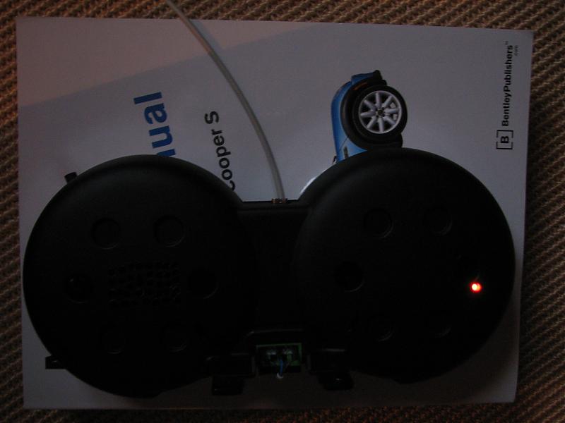

TOMTOM One new edition in double instruments cluster
Hello from Germany,
I´m new here in the forum and found this nice discussion about different mounts for mobile navigation systems.
What do you think about this solution? TOMTOM mobile navigation in the dual pod cluster (speedometer/rev.counter).
It´s for the Cooper Convertible 2007 of my wife. 12V to 5V Adapter and Mini-USB connector integrated in the housing. No additional cables, only the OEM 7-pin plug.

Im assuming you popped the glass out in order to be able to touch the screen?
Can you still get satellite reception?

yes, no glass on the right side. No probs with sattellites. System was installed for a short time and everything works great. But I need a new trim panel finisher steering column top (TWIN) part 51 45 7 157 357 (07/04->) because I have the wrong part 32 31 1 493 692. Tomorrow I get it.
But think about it, it´s a Cooper Cabrio (Convertible), so you have no Faraday Cage I think. No external GPS antenna needed, but TOMTOM offers it as an option.

amazing- could you let me know what TomTom model that is?
and do you have any pictures of the back of the pod- does the whole tomtom unit fit in there without modification.

It´s the TomTom One "New Edition", retail price in Germany 249,- Euro, and you need a dual pod cluster, retail price in Germany 260 Euro. There are some modifications on the TomTom unit.

you need a TomTom One "New Edition", retail price in Germany 249 Euro, also a dual pod cluster from BMW-Mini, retail price in Germany 260 Euro, a trim panel finisher (TWIN) from BMW-Mini, 10 Euro, a switch to disconnect the 12V when you have connection to your PC or Notebook via USB-Mini plug (both is optional). Also you need some other parts and hours of time.

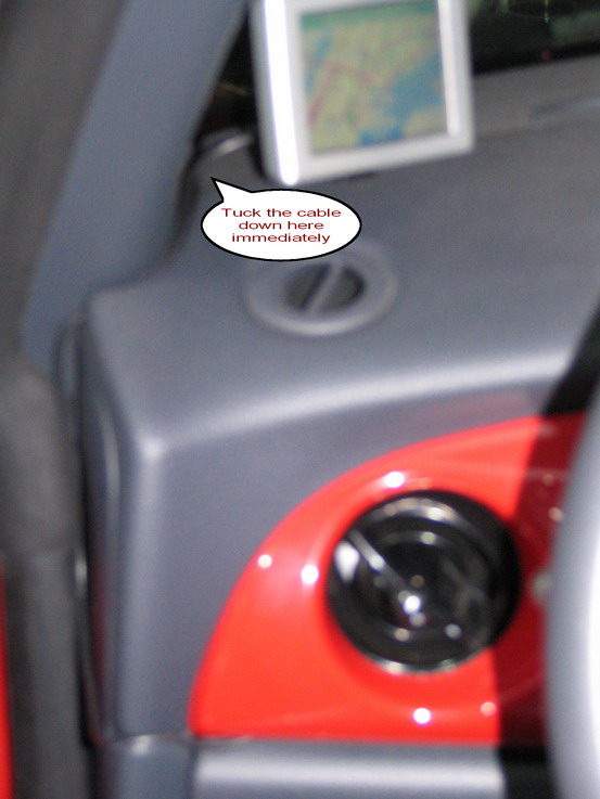

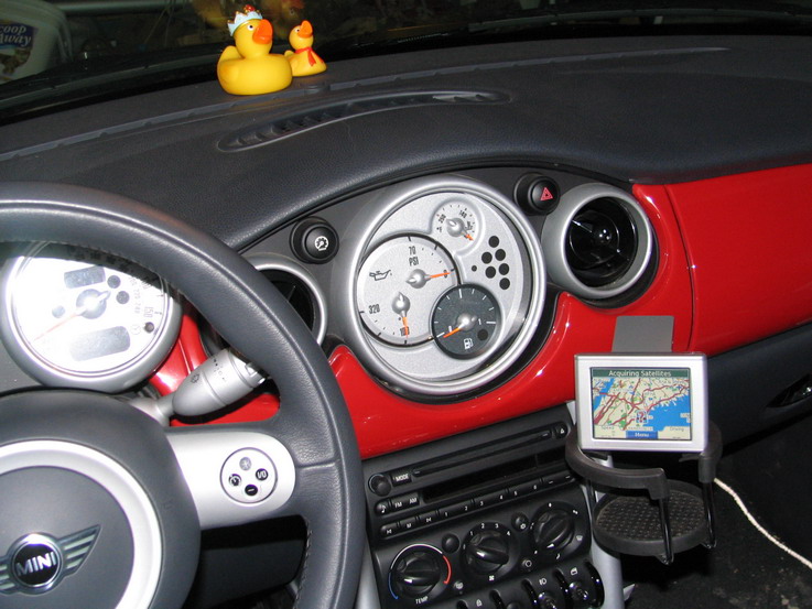

I have 2 sub-60 second solutions for mounting my Garmin Nuvi 350.
I did not want to drill or dismantle or velcro anything...
Quickest way:
Just pop it into the TOP ring of that godawful cup holder - it fits PERFECTLY, with enough grip that it does not pop out even on the twisties!
And boy is it easy! Convenient location, and you can just shove the power cable down in the back behind the lighter socket.
My preferred way (I dont live in CA)...
Suction mount in the lowest point possible on the driver's side lower left corner of the windsheild, then route the power cable down past the pillar, down, then nudge it in where the dash and the lower trim piece meet, al the way across under the steering columnm then back behind the pillars to the power outlet.
With just gentle nudging, it is virtually invisible, end easily reversible should you change your mind or need to pull the whole thing out to put it in another car. It's so easy to do...and really does not show. It really does not obstruct vision while driving at all.
It's positioned quite well for viewing and touching.
Oh yeah - I have also tried suctioning it to the Chrono panel, and the positioning is fine, but it doesn't seem to stay too long...suction loses it's grip, plus it does sorta block things you want to see.
Edited to add Pics...
(Sorry - 1 is blurry, but too cold in garage to go back down there!)
Also, pls excuse severe muddiness, but went driving through what I thought was spring thaw, with a few intrepid hikers, and we made a mess! :(
So 2 pics of my preferred method, and one of how it just fits perfectly in that lovely cupholder:
