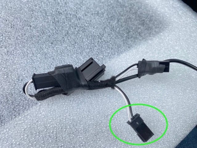

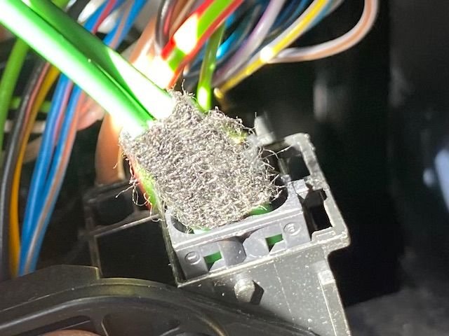

Front speaker wires:
The MMI box comes with a large loom connector that connects between the OEM loom and the radio. It has 2 huge connector blocks.
On my Harman Kardon system (don't know about standard radio) there are 2 wires in the original block that if you connect it to the supplied loom - it has blanks for these 2 wires ie they would come to a dead end. It does not provide for them to do anything. So you have to remove them out the OEM connector and connect them directly to block that will go into the radio. On mine these are green wires but I have seen reference to them being black in later countryman model.
Supplied loom
Disassembly of wires out of original block:
OEM block
tab to release the wires
coming out
released
Now put these 2 wires into the other end of the supplied loom. So when it is put into the radio the green wires will work properly.
The empty space where you will put your newly released wires
Putting the wires in
Now they are secured. This is the end that will go into the radio.

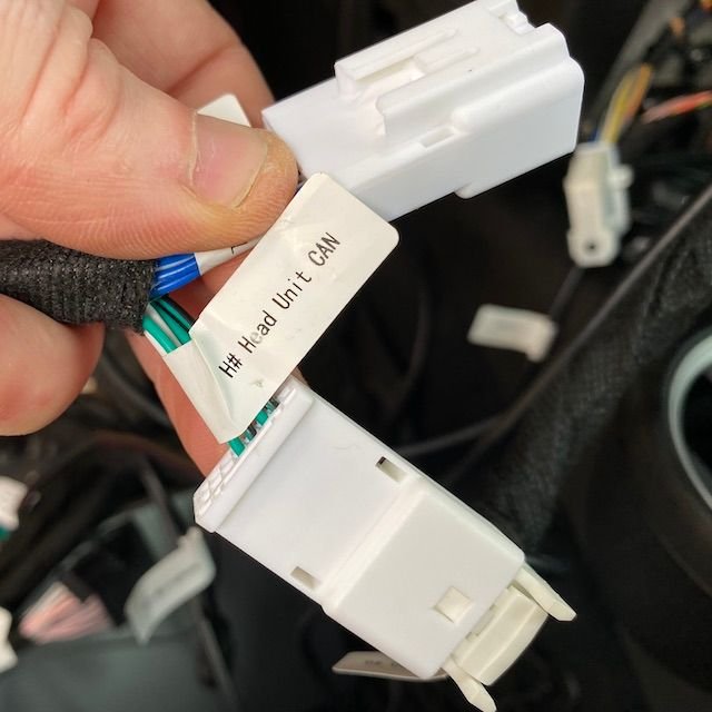

CANBUS wiring
There is some canbus wiring that is supplied - it connects with an offshoot of the supplied main wiring loom (the one with the 2 large connector blocks above). One section of it (with the black connectors) is not needed and can be discarded.
Separate it here
Discard this section
Disconnect the CANBUS CAN ALL OUT and swap it to the other white one named HEAD UNIT CAN:
Disconnect this CAN ALL OUT
Connect HEAD UNIT CAN
You end up with this section (in pic below) attached to the main supplied loom. The 3 unused connectors remain unused. It is a bit annoying in that sense as they just take up space.
This is the end result of the CANBUS section.

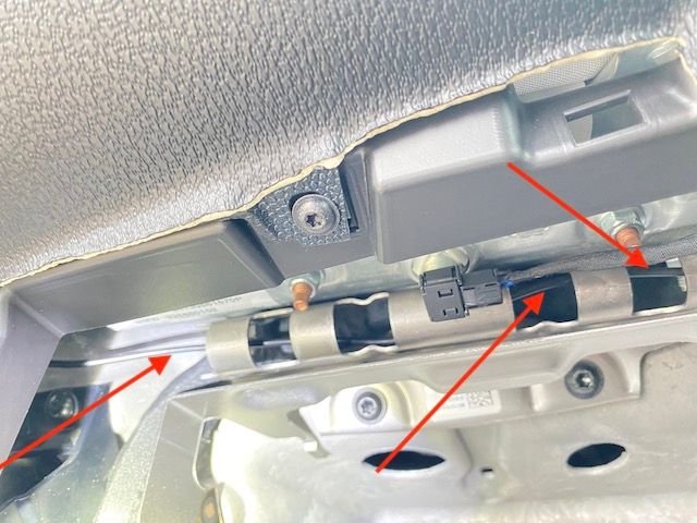

Microphone
There appears to be no easy way to use the original mic wiring and somehow getting the signal into the MMI box. So, you have to run a new (supplied) mic wire from the MMI box up to the headlining lighting panel where the original mic is. I experimented and you can use this new wiring with the original mini mic. So you unplug the original mic wiring and plug your new wire into it. It works.
Original mic and wire
2 torx retain light unit
Tape up 3 unused blocks on supplied wire to stop rattle. Only 1 fits the OEM mic.
Then run new wire along headlining. I removed sun visor to help have bit of flex with headlining.
and down the pillar
finally through this area above the small cubby-hole
down the back of radio, and join to the MMI box plug. I have it out front here just for photo.

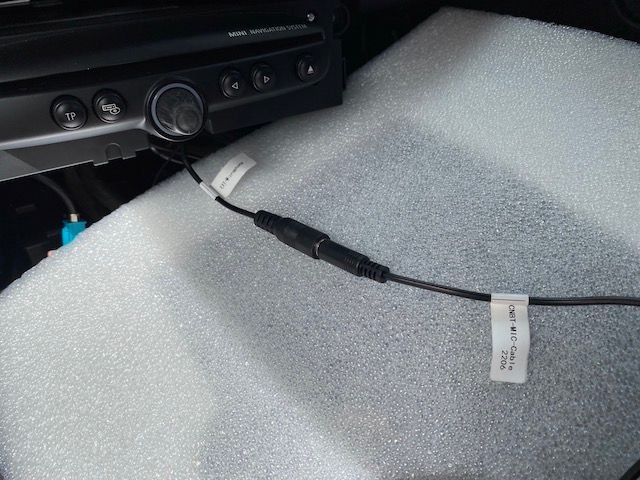

Hi
it goes here, I used a bit of firm aerated foam polystyrene type stuff above it about 1cm thick to stop any rattles. I sincerely can’t remember how it stays up, I don’t think I used sticky tape or anything, (although I may have done), I think perhaps the heater controls go in the underneath space and wedge it up? Anyway here’s where it is
you have to plug the aux cable into your car’s aux in port as shown (so this is plugged in permanently). The usb bit is also routed to be next to it so both of these are visible / available when job is complete

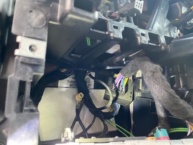

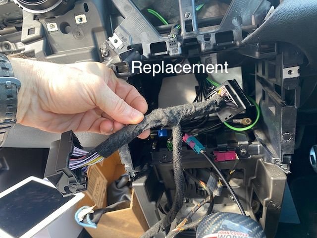

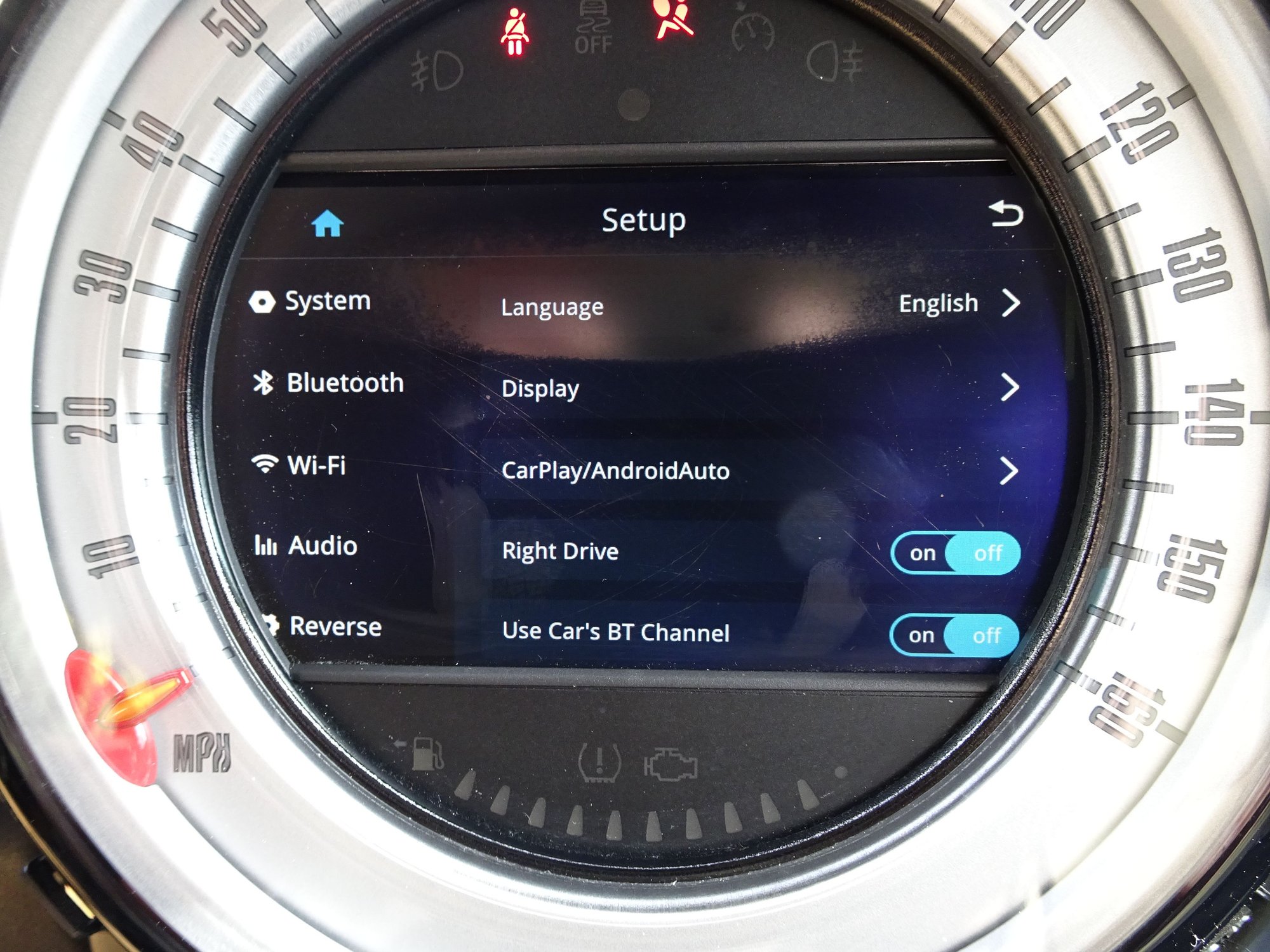

Very helpful pictures in this thread. I'm installing in a Mini Countryman (R60), so I have slight differences. I ordered a MMI "Prime" interface March 2025 from Andream and it arrived running the below firmware:
System Version: LC_EW_XU_B_V5.2.1R2
MCU Version: LC_10211_24.1.16.115
HW Version: LC_B_C_G
As my vehicle is equipped with the COMBOX (I believe this ECU is required if your Model Year 2011+ MINI has 6NF Music interface for Smartphone or 6NM MINI Connected), the factory analog AUX input wires and MIC wires all go the COMBOX, not the Navigation computer (CHAMP 2). The COMBOX then places audio from both of these wire sets on the fiber optic MOST bus for the Navigation computer to use. The Andream power/CAN main wire harness has AUX and MIC wires going to the large quadlock connectors to feed into the Andream unit... but the AUX and MIC wires aren't present (they go to the COMBOX instead), so you need to use the AUX plug and MIC jack leads on the Andream power/CAN main wire harness. I used both of these (with included aftermarket MIC) and the system works. This is good, but it still is a mass of wires to bundle behind my HVAC controls and I suspect the factory MIC is better quality.
The BimmerTech equivalent mentions "By enabling the Digital Bluetooth Audio option, sounds from your mobile device will skip the physical AUX connection and go straight to your BMW’s head unit."
Well, despite limited instructions from Andream on their User Interface... under the Andream SetUp menu there is an option titled "Use Car's BT Channel". I enabled this option and the Andream device rebooted. I connected my Apple phone to the MINI Bluetooth and selected that source under External Sources in the MINI factory menu. Now my Apple phone is connected via Bluetooth to both the MINI and the Andream unit. I disconnected both the AUX plug and MIC jack leads... and the system still works, just like BimmerTech advertises!
Is anyone else running Andream firmware new enough that your have this option and have skipped using the physical AUX plug and MIC jack? I would like to strip down the Andream wiring to the bare minimum... even eliminating the 2 large quadlack connectors. I still need to test more.
The attached pic is before I enabled "Use Car's BT Channel"
