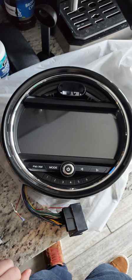

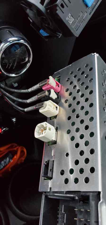

Old unit coming out
Getting these plugs out from the old radio was a pain the the ***
New display
Control **** . I didnt put this in yet i dont know that ill use it.

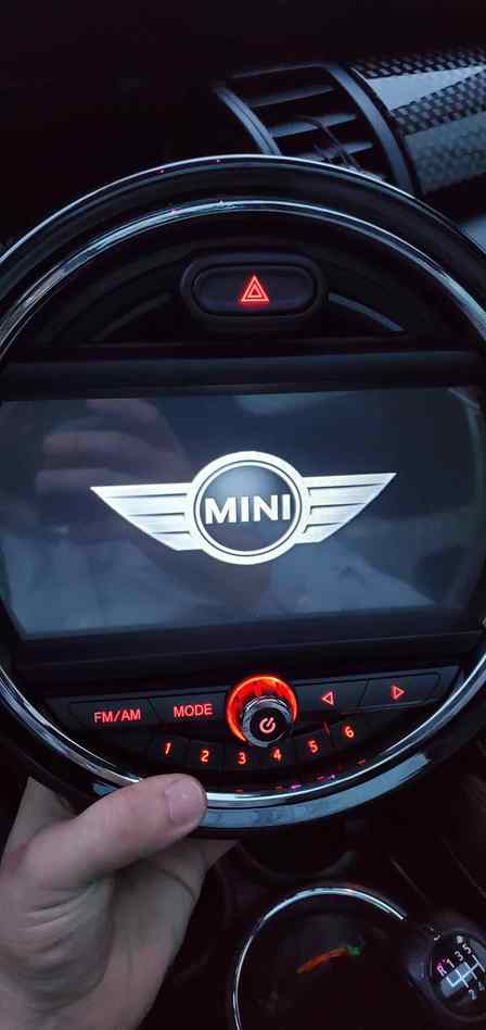

Startup screen

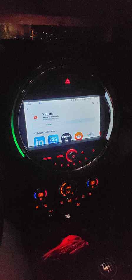

App store

So I received the headunit today and installed it. I was really nervous it wasn't going to work at all . Many of the plugs didnt get connected to the new unit I have no idea what I was doing I just connected everything I could to the places they fit. The only thing I could think that wouldn't connect was satelite radio antenna. But there were a bunch of wires that didnt hook up.
I did what I could and turned it on. I was shocked that it worked.
Actually I was really surprised at how well connected to the car this thing is. There is a car info menu with tire and oil check. It shows fuel efficiency and other computer info.
When the car is in reverse the camera screen kicks in. I dont have a cam so it shows black but I can see the tracks and they turn with the wheel. I'll have to order a cam now to use this.
The ambient light ring works and has a bunch of unexpected features. It changes when a notification is read for the nav. It shows rpms rise and changes color. It also change to solid red when brakes are applied hard. All of the original things like volume and heat/ac also change the lighting same as before.
