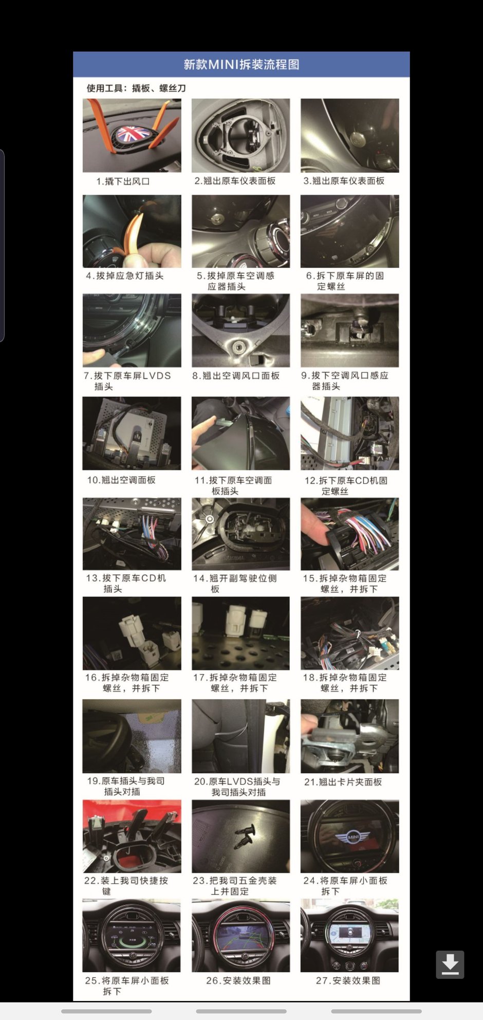

I have asked the supplier for a picture of the back of the unit. Do you know what cable is what and which one we don't use?

Left to right: USB cable, plugs into your existing cable and new headunit, adds another USB port, you lose aux input below lighter socket.
Next: video in, with some power switching wires, rev, dvr cam
Next: audio out front & rear
Next: 4G antenna, don't bother, it won't work
Next: GPS antenna, actually works well
Then your adapter cable from the cars wiring to the headunit.
My experience is that the TPMS will not work
The oil check will not work. You can see the screens but get a failure on tpms reset, and no action on the oil check. It shows a grayed out check button that doesn't respond.
There is a listed item to update the canbus version, so it may be possible to get it to work.
I tried 3 different SIM cards ATT, Verizon, T-Mobile, no sign of recognition.
The light ring shows all events, I haven't found a way to turn it off yet, I find it distracting.
FM reception seems fine, but I don't think the amp is as good as stock, and yeah, everyone complains about the stock amp.
If I would have known that the unit would not do the tpms and oil check I never would have bought it but the seller assured me that it would work like stock. I am not happy with it and will probably dispute the purchase with the seller. I feel that they lied about the abilities of the unit.
YMMV, I'm disappointed.

You use all of those. There are a couple from the car you don't use. This scared me when I installed but everything works.
The main harness connects to the existing wiring in the car.
The rest are things like 4g antenna, gps antenna and connections for the backup cam or pre amp output if you wanted additional speaker outs I belive. I didn't use them but some with more custom speaker and amp set ups might.

This is what it currently looks like after I remove the face. Now since I have a module in there to support rear and front cameras, I don't know what stock looks like.
How did the head unit slide out as a whole? Did you have to remove the two side vents?

Thanks M&M. I'm just going to unplug what's on the display unit now and plug those in to the new unit. I think there are a few more things to plug in? Like the GPS sensor, USB cord. Not sure if I should unplug my cameras from the module and plug them to the new unit.
btw, this is the installation instructions the vendor sent me when I asked for it. I'm sure they came with the unit but if anyone here needs them.
