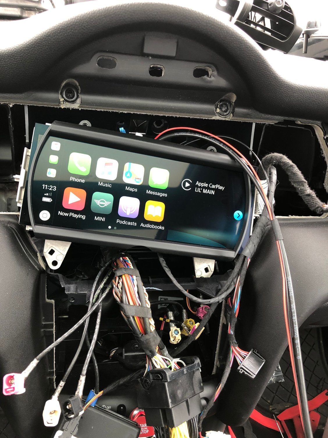

Yes, I had a BMW ID5/6 headunit coded to work with my F56. It fits and works flawlessly. Be careful about the GPS port though. Most newer BWM units don't have the blue GPS port and you'd need an ATM emulator.

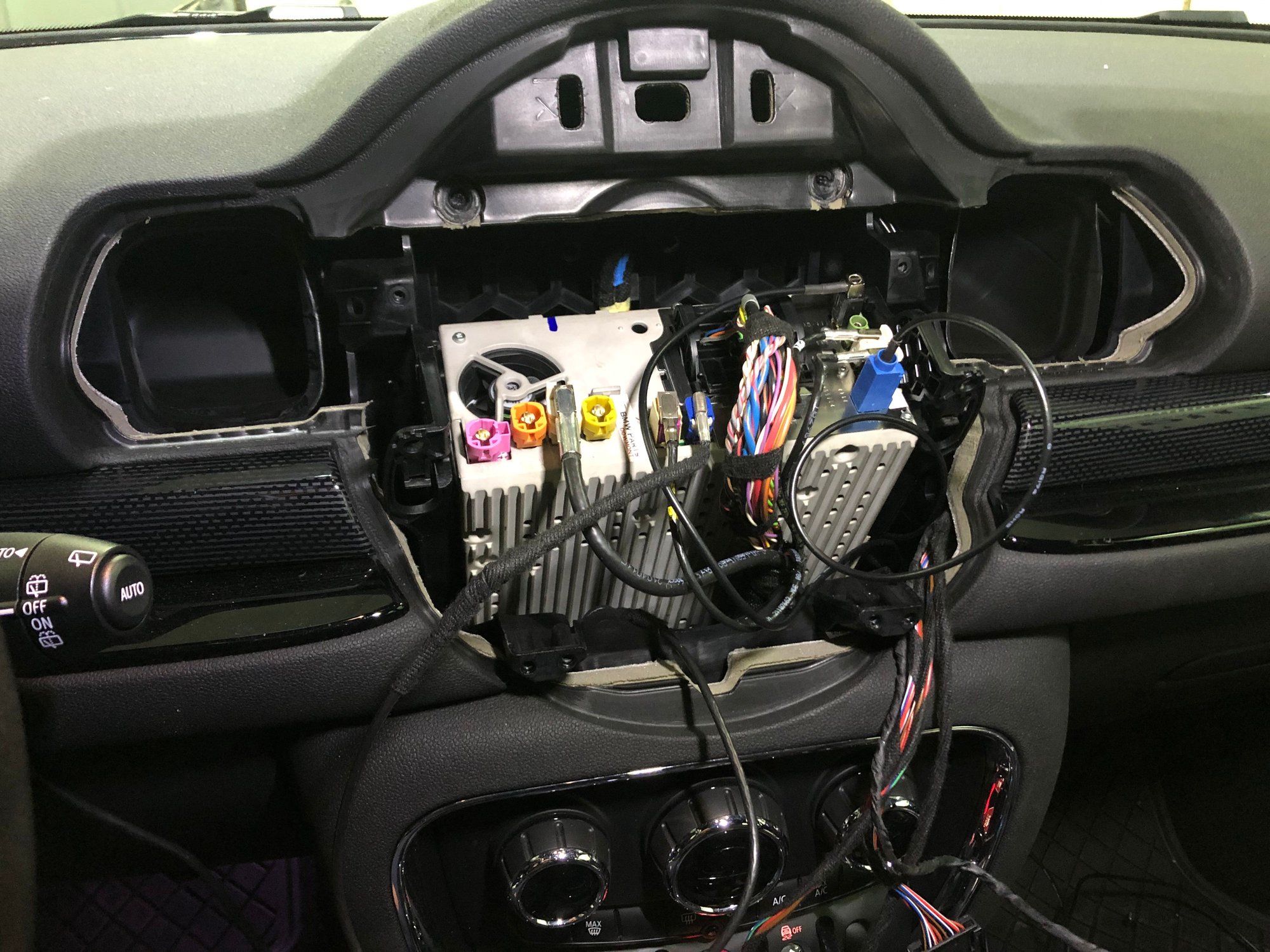

Some hardware pictures.

It wasn't cheap by any means but I feel like it completes my Mini. The Carplay integration with iDrive is just really nicely done.

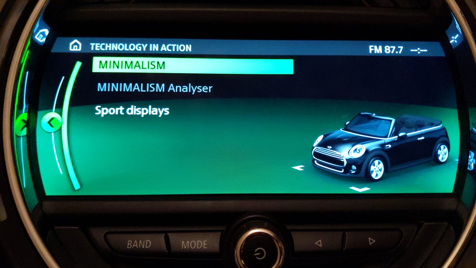

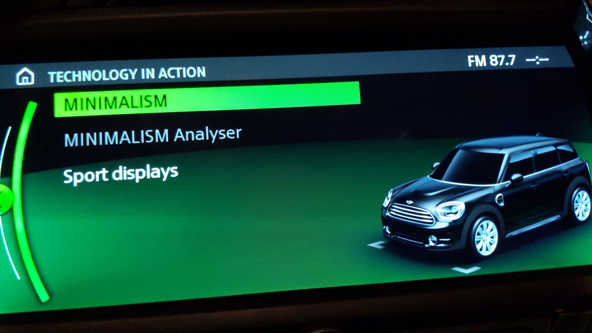

Ive got my nbt Evo coded, fsc added for Nav, wireless CarPlay etc and it all works. The final thing to resolve is the 3D graphics, animations and manual; they are for an f60 and not my f56 and the online manuals are inaccessible. How do I get the unit to display the f56?

To answer the OP's question. Yes you can flash any BMW Evo to run Mini HMI. I only look for evos to buy not Mini Evos.
Just got mine updated today with F55. And the manuals. It was a pleasant surprise. I was using tool32 for something else. Re injected cafd it just magically appeared.
I had countryman graphics on my retrofitted id4 to id5 also (another unit). I'm gonna try the same tool32 job on this unit shortly. Will let you know.

Hi all,
I'd like to give to the community another feedback about this topic: yesterday my coder was able to successfully flash my BMW's Nbt Evo (coming from a G01 vehicle) and convert it to Mini F54 GUI.
He told me he flashed the headunit with my VIN using latest F56 Psdzdata, and then he loaded FSC files without problems at all.
Matt

Below some pics of the installation performed today:
