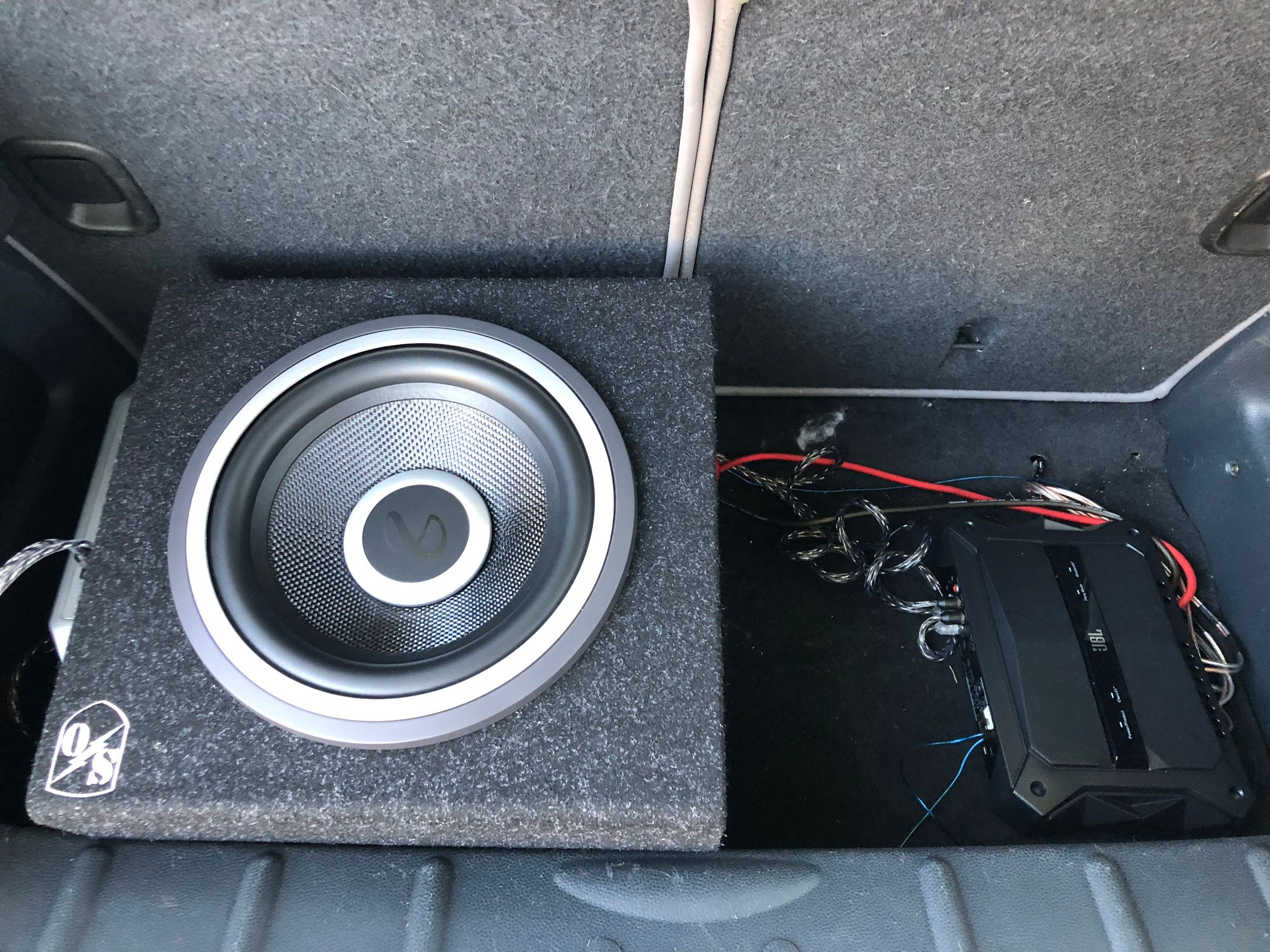

I just took it out today, actually. Two of the speakers were worn out to where they just didn’t sound good. I ended up removing the HK amp and went with an Infinity setup. Much happier, but it was a royal pain in the butt.
New door speakers
Sub and amps
New crossovers for the new speakers.
New 6x9s
