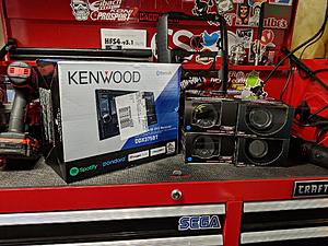

R56’s axxess LC-BMRC-01 wiring interface help?
Any one ever installed the LC-BMRC-01 before that mit be able to shed some light on somethings, Just wanted to be able to have the chime & radio ! For the most part it seems pretty straightforward’ untell you get to the part with the yellow wires ! & running it to the battery! Do you tie 3 of the yellow wires together ? Just seems goofy’ why would you, need to tie in a power source’ with a oem plug ?
Not going to do the steering will control seems like a pain in the *** if it needs to be reprogrammed ever time the battery dies !
Anybody have any photos of the wiring harnesses all done up’ I did see that video on YouTube but it never really went into depth with the wiring harness
Attached Thumbnails -60f44320-de51-49e6-b56d-4d2233720d9c.jpeg   -369b57ad-82de-4d4c-8626-c39fbbd0c8bb.jpeg   -001ce26f-790e-4ac2-9ab9-1090802200e7.jpeg
