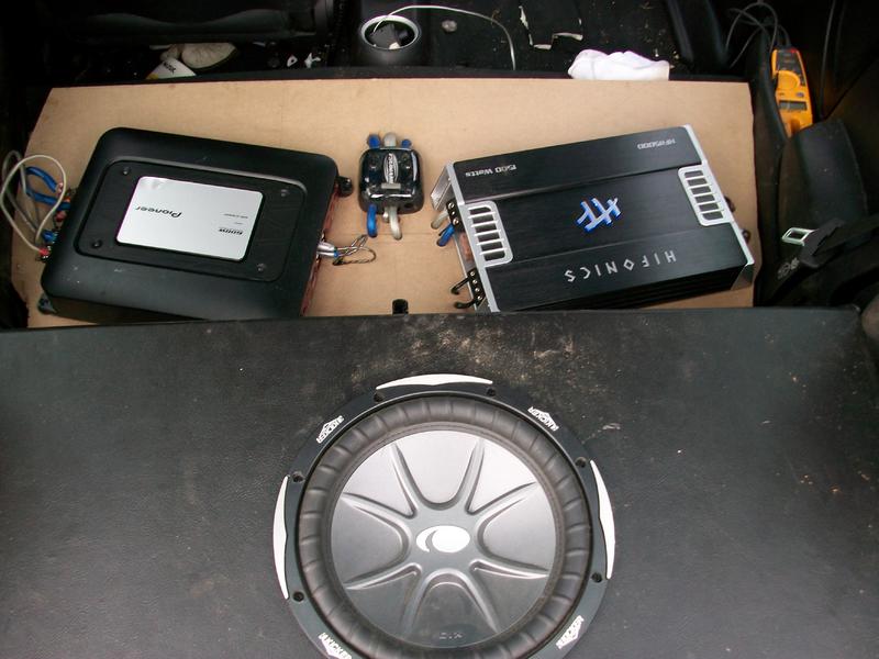

Mine is in Progress
Here are my amps and enclosure. The amps are 1) Hifonics HFI 1500d running a soon to be in place Kicker CVX10 dual 2 ohm coils, 2) Pioneer GM6400F powering a set of Kicker KS 6.02 components soon to be upgraded to the Kicker QS series. Also on deck for install is a Pioneer DEH 8300-UB head unit. Currently I am using an Audio Control LC6i for line converter.

I was actually thinking of going from the single 10 to 2 8's. If I do I'm willing to make a great deal on my sub but I dont think your amp can runit. Thats what happened to me. I satarted with a single 10 polk db and the Kickers off the pioneer the polk blew got a killer deal on the cvx, guy thought it was a cvr, and then realized I neede new amp. I think You should be fine with the 8 maybe add second one.

Thats cool Thats what Im in the middle of doing I went from a vented enclosure that actually was too small bc guy thought he had a diff sub to a sealed enclosure I built that internal volume after speaker displacement and bracing is 1.45cu.ft. its right in the middle of Kickers specs plus I doubled the front bffle to really stiffen it up. The new Alpine PDX f4 I believe is the model is a super nice amplifier. Im not sure your background or such if you need any help hit me up I've been doing mobile electronics on and off for 8 years and am a Master Electrician. You may try a larger box for the 8 closer to the SQ specs. Ive heard some 8's that didnt sound like 8's at all I had 4 8 jlw6's in a prelude that was rediculous.

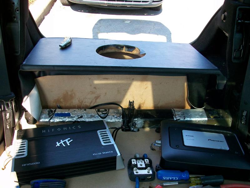

still in Progress
Well I know its a couple days late but here is some further progress. Pardon the unfinished project but still trying to decide on how to finish the trim panels or to stay without the rear seat.
