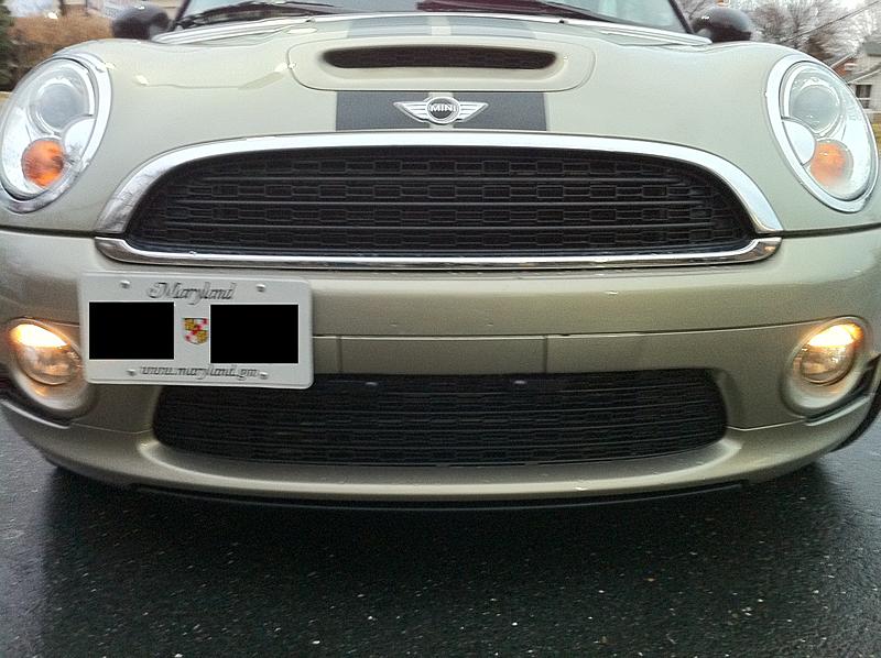

You have mounted the pickup in the bumper? I thought the idea was to get it mounted as high as possible. What about the rear pickup, it's is one of the best features of the V1?? I think the stealth idea is great, but only if it doesn't cutdown on the detectors efficiency.

you can mount the detector and the electronics separatly. So put the head unit whereever you want it and the stealth display and control still work.

From my reading (mostly on radardetectors.net), no. The idea of getting it high is so it can "see" over the traffic in front of you. Going low has the same effect. In fact, it might be better.

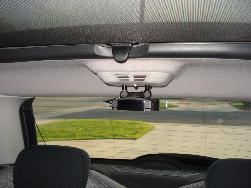

Very cool I have my V1 remote mounted hanging off the alarm module on the headliner. It picks up front and back. I have both the remote display and audio units. Can someone just buy the mirror only? Question for you though, since the V1 points both forward and back how does that work with it mounted in the front bumper? And can it be removed for use in another vehicle?

Radio waves penetrate all, they won't be stopped buy a thin plastic bumper.
HOWEVER... you probably will give up the pretty much useless laser detection. That's line of site.
