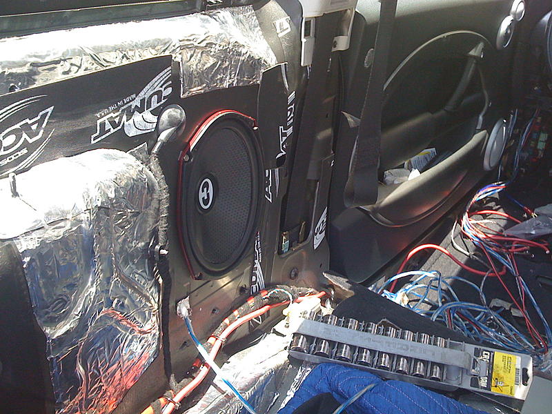

i have tested a pair of jl audio 8w3v3 in the rear 6*9 space
pics here
conclusion = to much bass from the jl's (250 to 300 rms) .. you could see there was tooo much vibration at the rear exterior wing .. so i'm relocating them ...
don't go over 100 rms at rear wing
pics here
Elegant looking install.... I think 8's in the rears would be a bit much for me however. Thanks for sharing.

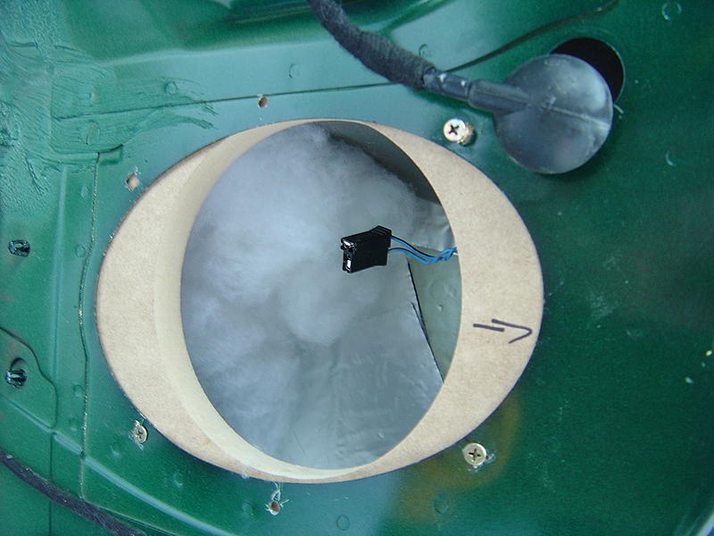

I have them mounted in the 6x9 holes. I had a 1/2" MDF cutout that I mounted on the inside of the cavity so it would accept the 6 1/2" sub. Then I used a Sony Slim amp (4 channel amp, 2 channels for the fronts and about 100W per sub...personally it is probably closer to 60-70w per channel). The amp easily mounted in the passenger side rear pocket in the boot. I also used the Elemental Design 6 1/2" components for the front. (http://www.edesignaudio.com/product_...products_id=49) Installation of these components was a but of a bear to do, but they fit....barely
My goal was to have a clean installation (you see nothing) with no space taken up from the stereo system. Is it the best sounding system out there...no way. But it gave me more bass, better highs, and it didn't cost me more than $600 for the entire sytem upgrade.

Old Jun 29, 2009 | 04:35 AM
GreenBrit's Avatar
GreenBrit
Joined: Oct 2006
Posts: 54
From: Savannah, GA
Here are some pics
Attached Thumbnails Rear 6x9 Question-stereo4.jpg   Rear 6x9 Question-subwoofer_2.jpg
