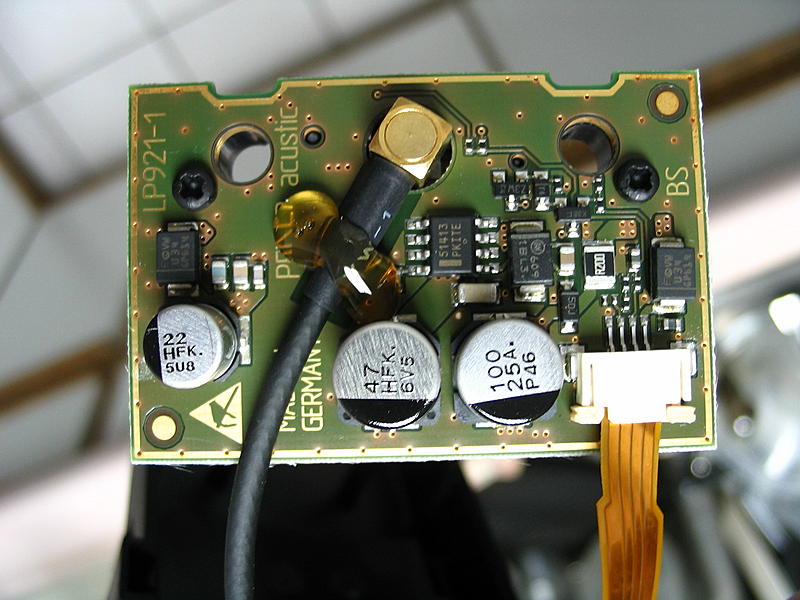

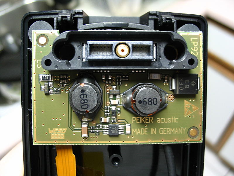

I wonder what the connector in the snap-ins looks like?

This is from the Razr adapter

Wow - thanks so much for the pict's
The antenna part looks kind of like what I thought it might... yet another thing to research...
